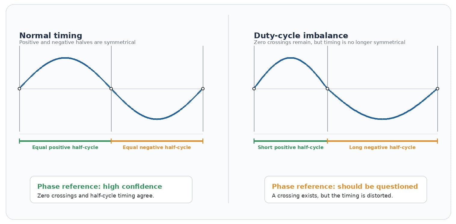

Zero Crossings Are Not Enough
Many AC synchronization systems begin with the zero crossing. That makes sense: the zero crossing is easy to detect, repeats every half-cycle, and provides a convenient reference point for timing. But a zero crossing alone does not prove that the AC waveform is healthy.
Compare the imbalanced AC waveform at the right side of Figure 1 to the normal waveform at left. The positive half-cycle and negative half-cycle in the imbalanced signal are not the same duration. The waveform still crosses zero.
Figure 1. A zero crossing can still be present even when the positiveand negative half-cycle timing is no longer symmetrical.
Figure 1. A zero crossing can still be present even when the positive and negative half-cycle timing is no longer symmetrical. [click to enlarge]
A zero-cross detector may still produce a clean-looking pulse. A downstream synchronization system may still report that it is tracking. Yet the timing of the positive and negative halves is no longer symmetrical. Therefore, the timing confidence is different.
This type of duty-cycle imbalance can come from:
  • Distortion
  • Asymmetrical loading
  • Measurement imperfections
  • Local power-system behavior
  • Equipment interaction.
The key point is that the zero crossing can continue to occur even when the timing implied by that crossing is not a stable or fully trustworthy phase reference.

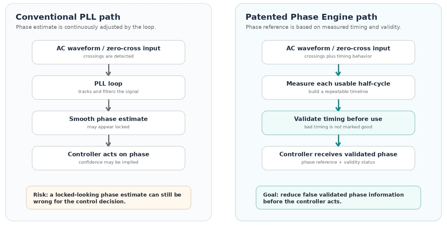

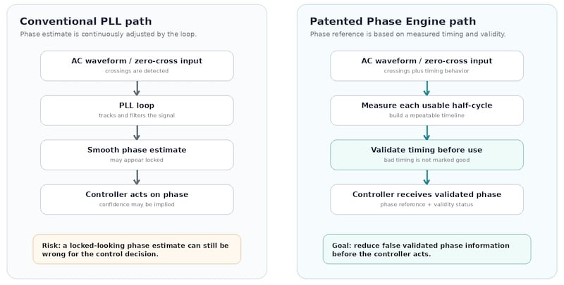

The Phase Engine Solution: Measured, Validated Phase Timing
The patented Phase Engine is not just another way to smooth or filter a phase estimate. Its purpose is to create a usable AC phase timeline from direct measurement of the waveform timing, while also helping the controller decide whether that timing should be trusted.
Let’s examine the differences between a conventional PLL path and the Phase Engine path as illustrated in Figure 2.
Figure 2. A conventional PLL path compared to a Phase Engine path that adds measured timing and validity before the controller acts. [click to enlarge]
Instead of depending on a conventional PLL loop to chase the incoming waveform, the Phase Engine measures each usable half-cycle and builds a phase timeline from that interval. The controller can then act from the waveform period that actually occurred, not from an estimate that may have been pulled by distortion, imbalance, or interaction with other equipment.
Just as important, the Phase Engine is designed around timing validity. When the waveform timing is usable, it can provide a repeatable phase reference. When timing is questionable, the system can avoid presenting bad phase information as if it were good.
The central value of the Phase Engine is that it reduces the likelihood of false validated phase information.
A conventional PLL path can imply confidence from loop behavior. A Phase Engine path adds measured timing and validity before the controller acts
This does not mean the Phase Engine makes a bad AC waveform clean. No synchronization circuit can do that. The goal is more practical: prevent the control system from confidently acting on phase timing that should not have been trusted.
In power electronics, a wrong answer marked "valid" can be more dangerous than no answer at all. The Phase Engine is intended to give the controller a better choice: use the phase reference when the timing is valid, and withhold confidence when the timing is not valid.

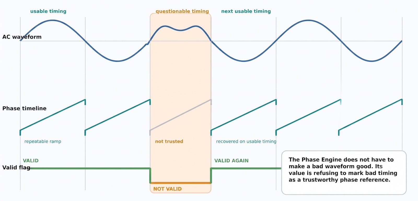

Why Fast Recovery Matters
A synchronization system should not only detect bad timing. It should also recover quickly when good timing returns.
In many AC systems, disturbances are temporary. A load changes, a transient occurs, a distorted cycle passes, and then the waveform becomes usable again. If the phase reference takes many cycles to settle, the controller may be forced to wait or operate conservatively.
However, if valid timing can be re-established on the next usable cycle, the controller can return to normal operation more quickly. This is demonstrated in Figure 3.
Figure 3. The desired behavior is to use valid timing, withhold questionable timing, and recover when the next usable cycle is measured. [click to enlarge]
This is valuable for systems that make time-sensitive decisions. Current injection, switch timing, sampling windows, and protection thresholds can all depend on knowing where the controller is in the AC cycle. A timing architecture that quickly rejects bad information and revalidates good information gives the higher-level controller better data.
