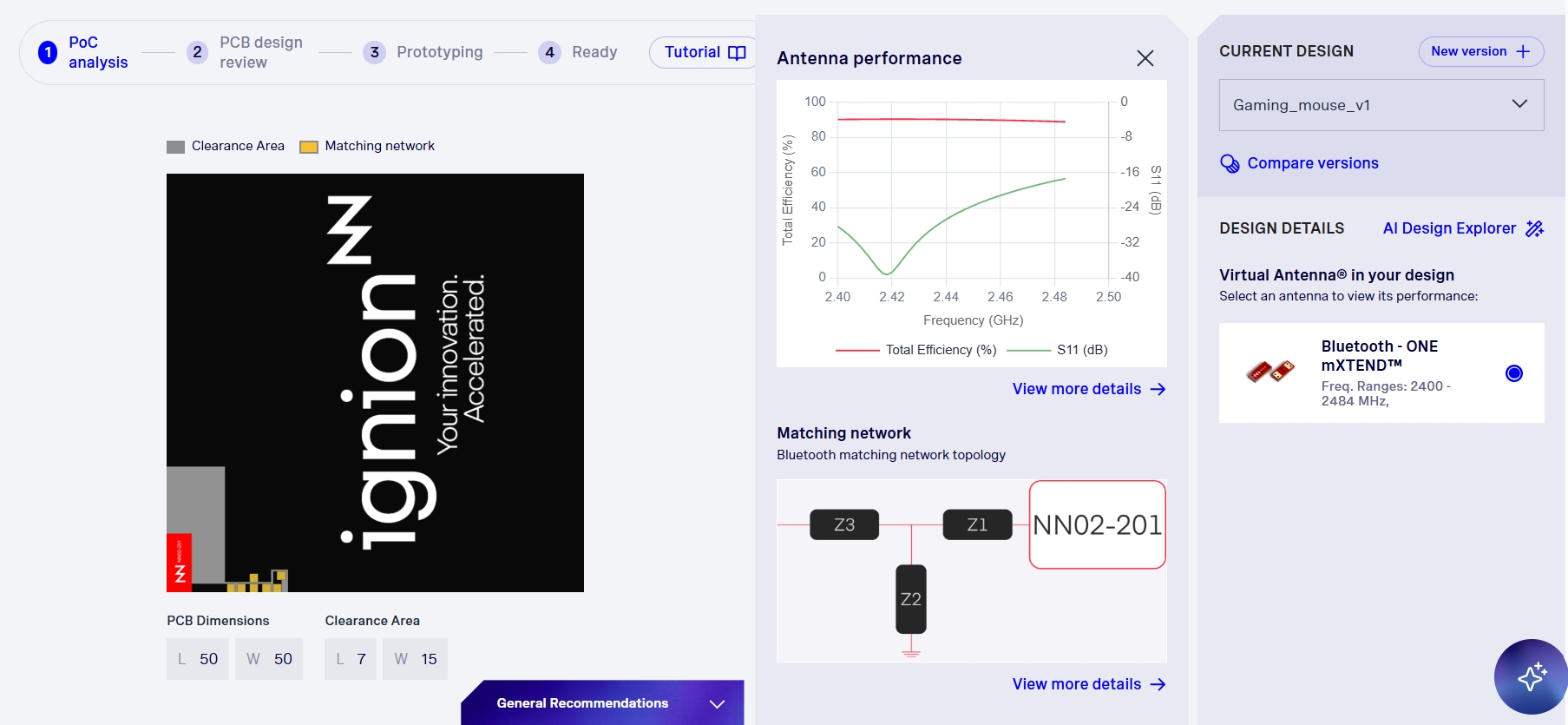

Software tools are available that can help improve designs before committing to any hardware. Ignion’s antenna integration platform, Oxion, prioritizes antenna selection and design-in, with its Virtual Antenna technology (Figure 2). This provides a range of chip antennas, optimised for popular wireless technologies and applications such as asset tracking and IoT devices, and accurately modelled in software.
The RF system performance and antenna integration can be assessed indetail at PoC.
Figure 2. The RF system performance and antenna integration can be assessed in detail at PoC. (Click on image to enlarge)

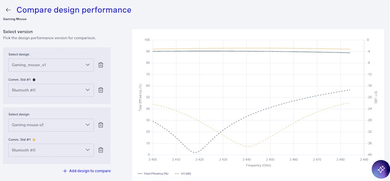

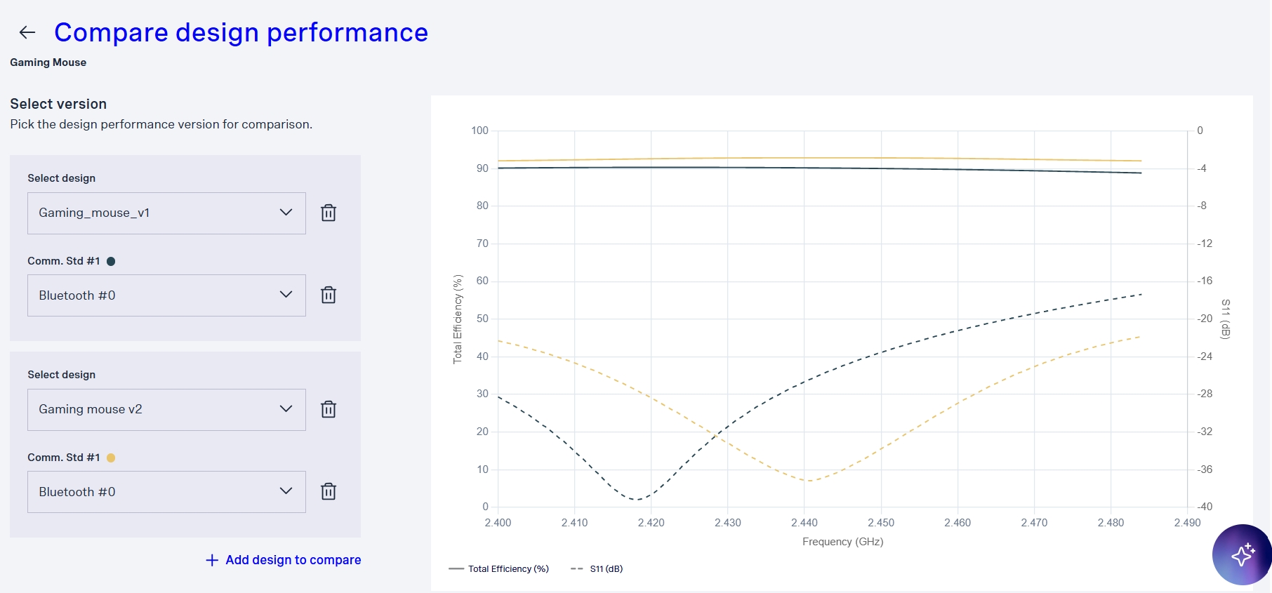

Oxion helps with antenna selection and enables engineers to quickly evaluate the performance in the digital world and quickly refine their designs through rapid iteration enabled by the platform’s proprietary machine-learning model. Comparing the performance of different iterations (Figure 3) shows how the design is improving and helps accelerate the project.
Graphical performance comparisons help engineers find the wayforward.
Figure 3. Graphical performance comparisons help engineers find the way forward. (Click on image to enlarge)

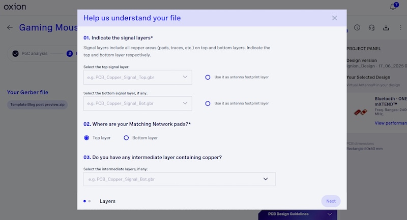

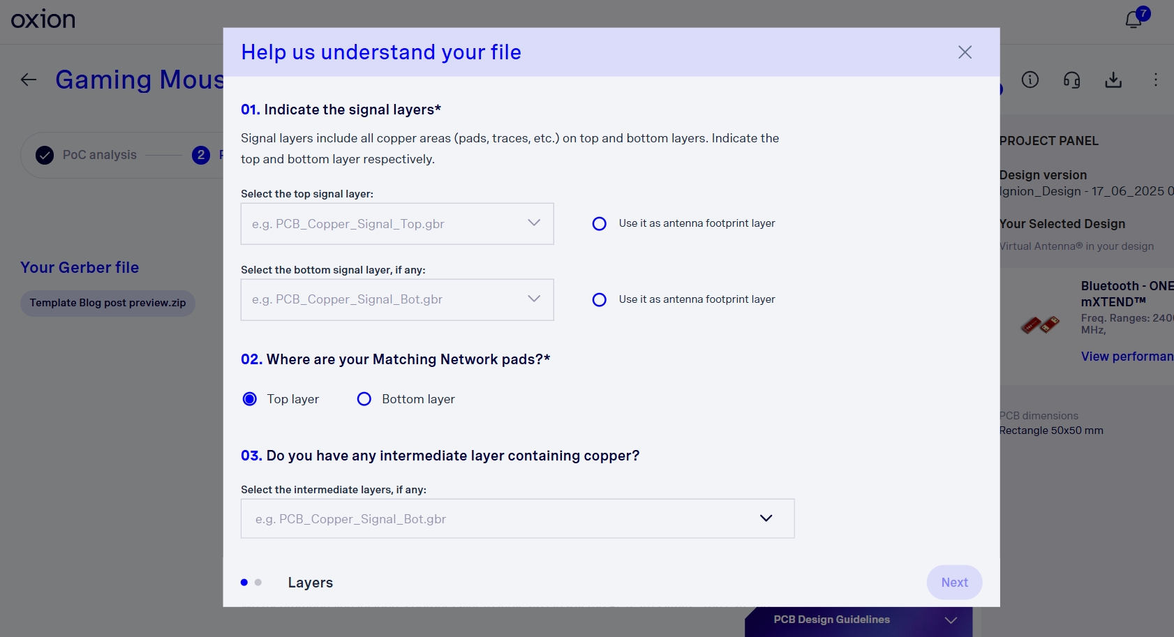

The latest release, Oxion 2.0, automates more of the design process by adding PCB gerber review tools to existing features such as the AI Design Explorer provided in version 1.0. AI Design Explorer is the interactive tool that enables rapid iteration and assesses the real-time performance impact of design changes.
It draws on the experience of thousands of project examples to help optimize the antenna design including placement, dimensions, and clearance. The PCB gerber review (Figure 4) supports a wide variety of use cases and automates checking of the design for compliance with guidelines and requirements appropriate to these, including validating the antenna integration.
The PCB gerber review helps ensure all engineering issues areconsidered properly.
Figure 4. The PCB gerber review helps ensure all engineering issues are considered properly (Click on image to enlarge).

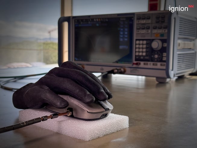

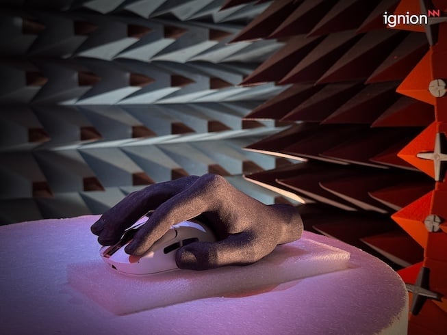

Using a vector network analyser (VNA), the most important parameters to check are the antenna impedance and reflection coefficient. In the wireless mouse project, the enclosure or the presence of the user’s hand (Figure 5)—as well as parts such as batteries or metallic components close to the antenna—can cause detuning. The VNA results can guide any needed adjustment of the matching-network components to restore the antenna performance, ultimately helping achieve the desired user experience.
The first prototype should deliver close-to expected performance,
using results from the test chamber to guide any adjustments.
Figure 5. The first prototype should deliver close-to expected performance, using results from the test chamber to guide any adjustments.
