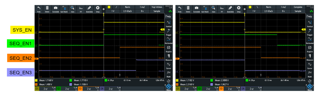

The next generation of FPGAs consists of multiple internal power domains that must start up or shut down in a specific sequence to ensure proper functionality. These internal power domains are divided into several groups.
Figure 2 shows the start-up and shutdown sequences of tree groups for Intel Agilex. Proper power sequencing helps prevent problems including voltage spikes, excessive current draw, unstable clocks leading to timing violations, and other electrical issues that can lead to damage or malfunction.
Start-up and shutdown sequences of tree groups for intel Agilex.
Figure 2. Start-up and shutdown sequences of tree groups for intel Agilex. (Click image to enlarge)

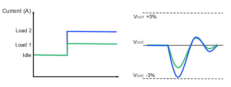

On the other hand, important considerations must be taken regarding the output voltage ripple (∆VOUT) or allowable variation from the nominal voltage specification, where most of the rails require VOUT accuracy within 2% or 3%. This is one of the most challenging FPGA design constraints, particularly in applications where the workload varies dynamically or when different parts of the device are activated or deactivated as necessary.
Excessive voltage ripple can lead to issues in FPGA operation, especially in sensitive analog or mixed-signal applications. Figure 3 shows a change in the load current without causing a significant deviation in VOUT (within the target ±3% tolerance).
Output voltage ripple and dynamic power tolerances
Figure 3. Output voltage ripple and dynamic power tolerances
VOUT is maintained within the target tolerance using the voltage controller circuits. These circuits adjust the voltage to meet the specified levels, preventing unwanted fluctuations that can affect the performance and reliability of the FPGA and connected components. It is essential to maintain the voltage level requirements of each FPGA’s rail within the specified tolerances for optimal performance. Furthermore, maintaining VOUT within the target tolerance ensures accurate signal processing as well as compatibility with other devices in the system.

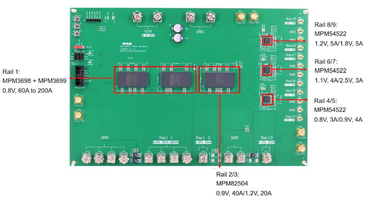

Furthermore, the EVINAG-001-A FPGA evaluation board from the Intel Agilex reference design can be used to evaluate the performance of the MPS power modules and check that the specifications from Table 1 are obtained (see Figure 7).
EVINAG-001-A FPGA evaluation board for Intel Agilex
Figure 7. EVINAG-001-A FPGA evaluation board for Intel Agilex

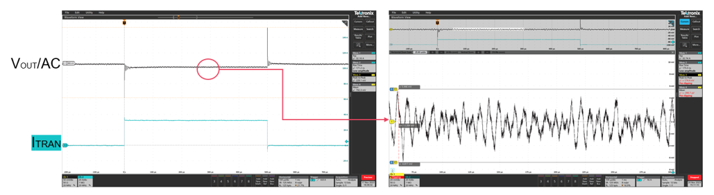

Figure 8 shows the load transient response and ripple measurement for the VCC/VCCP core rails using the specifications given in Table 1. The total required output capacitors are 32 x 47 μF multilayer ceramic capacitors (MLCCs) and 4 x 330 μF polymer capacitors (POSCAPs).
Load transient of the MPM3698 and MPM3699 using the EVINAG-001-A FPGA evaluation board
Figure 8. Load transient of the MPM3698 and MPM3699 using the EVINAG-001-A FPGA evaluation board (VCC/VCCP Core Rail with ∆IOUT = 32.5 A, Slew Rate = 325 A/μs, VIN = 12V, VOUT = 0.8 V, and fSW = 500 kHz). (Click image to enlarge)
In Figure 8, the peak-to-peak VOUT during load transient is 228.1 mV and the output ripple measurement at heavy load currents (right waveform) is 12.264 mV. This is within the ±3% maximum VOUT tolerance (DC + AC). Refer to the EVINAG-01-A Test Report for additional measurements for the Intel Agilex FPGA power tree with the complete MPS module solution under different load step specifications.

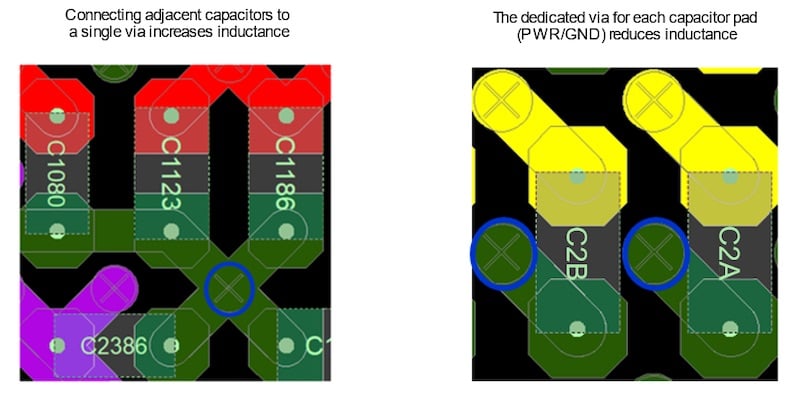

Particularly in high-speed, high-density PCB designs, small improvements in the decoupling network can have a significant impact on the FPGA’s overall performance and signal integrity. Decoupling capacitors should be strategically placed throughout the PCB layout to effectively filter and decouple power and ground connections.
Additionally, every core BGA pin requires a direct connection to high-quality ceramic capacitors. Although traditional design guidelines recommend placing the decoupling capacitors on the bottom side of the PCB, it is essential to understand the tradeoffs and considerations involved. Integrating additional parts in space-constrained areas requires allocating capacitors to share the same vias.
The parasitic elements of the vias (for example, inductance and resistance) can impact the effectiveness of the decoupling network, and there are scenarios where sharing vias may have an impact on overall performance. Figure 9 shows the recommended capacitor layout for the FPGA design.
Recommended capacitor layout for the FPGA design
Figure 9. Recommended capacitor layout for the FPGA design
