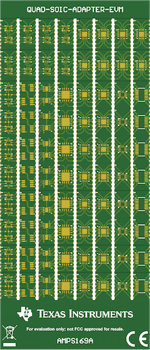

  • The quad (14-/16-pin) SOIC adapter EVM (Figure 6)
TI designed each variation to convert footprints of larger legacy packages into their next-generation successors.

Quad SOIC adapter EVM.
Figure 6. Quad SOIC adapter EVM. (Click image to enlarge)
