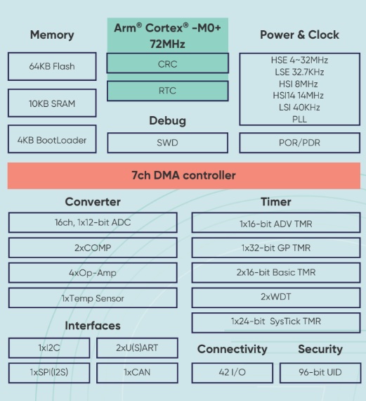

The chip is a 32-bit FOC motor control dedicated MCU and is based on the Arm Cortex-M0+ core operating at 72 MHz. An M0CP co-processor that includes a shift unit, 32-bit/32-bit divider, multiply-add operation, square root, trigonometric functions, and SVPWM further enhances performance. The block diagram of Figure 3 summarizes various features of the APM32F035.
Block diagram of the Geehy APM32F035
Figure 3. Block diagram of the Geehy APM32F035. Image provided courtesy of Geehy

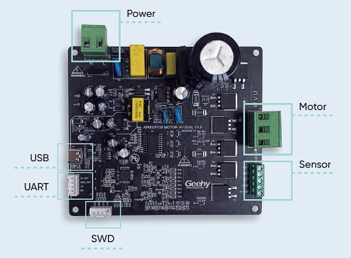

The MCU also integrates motor-specific PWM for complementary and brake modes linked with M0CP. Figure 4 shows the high-voltage motor control evaluation board, but a low-voltage evaluation board is also available.
High voltage motor control evaluation board for the APM32F035
Figure 4. High voltage motor control evaluation board for the APM32F035. Image provided courtesy of Geehy

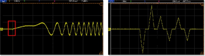

Conventional startup methods struggle to address initial position detection (IPD) effectively, but the APM32F035, with its innovative initial position detection feature, aids in overcoming this limitation. While saturated or variable inductance is typically the industry standard, the MCU amplifies the current within the designated red region, injecting six pulses to achieve a precise and discernible signal, as illustrated in Figure 5.
Geehy implementation of IPD
Figure 5. Geehy implementation of IPD. Image provided courtesy of Geehy
