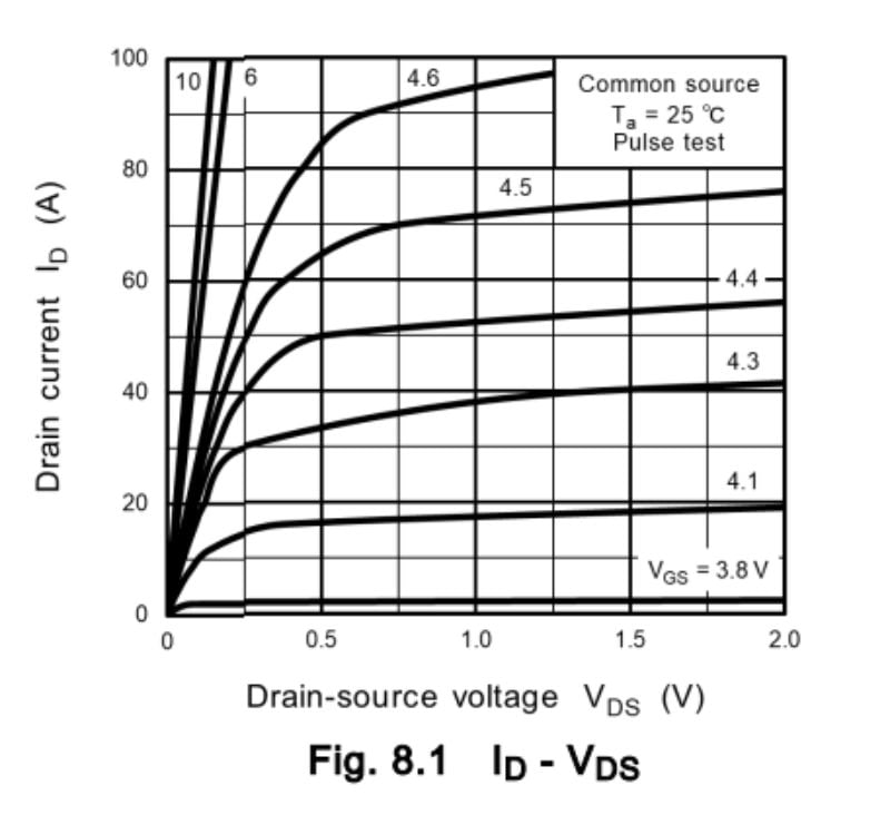

The TPM1R908QM’s output characteristic curve
The TPM1R908QM’s output characteristic curve. Image used courtesy of Toshiba
