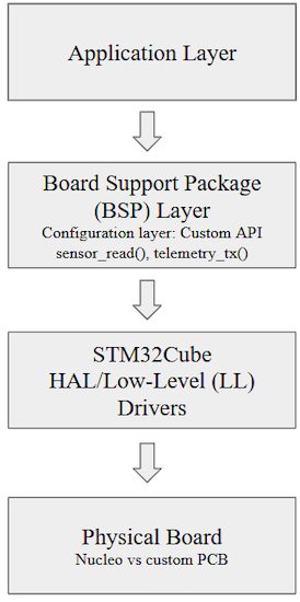

The Strategy: Decoupling Application Logic from Hardware
Many firmware changes that occur during custom board development are driven by tight coupling. You need to avoid writing application logic that writes to specific registers or calls highly dependent Hardware Abstraction Layer (HAL) functions for specific pins because that will constrain your code to a tight hardware layout.
Instead, implement a layered architecture with the following layers:
  • Application Layer: not dependent on the physical pins or peripheral instances you are using; uses business logic like processing sensor data or handling state machine transitions.
  • Hardware Abstraction Layer (HAL/BSP): Ties more abstract application requests to physical pin assignments, registers, and clock configurations.
When you are transitioning from an off-the-shelf board like the STM32 Nucleo board to your highly customized miniature board, you only need to modify the configuration (BSP) layer and should not modify the core application logic. Figure 1 illustrates the layered architecture flow for switching from a Nucleo board to a custom PCB.
Figure 1.
Figure 1. Layered architecture flow for switching from Nucleo board to custom PCB.

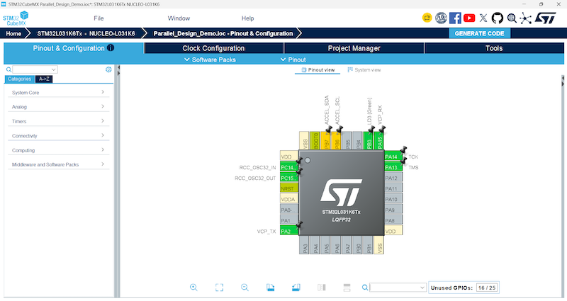

Setting Up the Parallel Pipeline in STM32CubeMX
When you transition away from the development kit to your custom board, all changes are made within the BSP source file and using the graphical configuration tool. As demonstrated in Figure 2, assign logical User Labels (ACCEL_SCL and ACCEL_SDA) to physical I2C pins within the STM32CubeMX Pinout view to decouple hardware layout dependencies from generation files.
Figure 2. Assigning logical User Labels to physical I2C pins within
the STM32CubeMX Pinout view.
Figure 2. Assigning logical user labels to physical I2C pins within the STM32CubeMX pinout view.
First, configure the Nucleo baseline by initializing the project and selecting the Nucleo board. This will configure your main system clocks via the internal HSI oscillator and map your debug communications interface. Then assign user labels to your pins. Do this by right-clicking on your configured pins in the CubeMX pinout view. You then have the option to label the pins, for example: ACCEL_SCL, ACCEL_SDA. CubeMX will create object macros for the labels in the main.h file.
When you receive your custom PCB, you only need to make two adjustments: Open CubeMX, map I2C1 to the pins you are using, and regenerate. If using another peripheral instance, like switching to hi2c2, just change the single external reference in the bsp_sensor.c code.

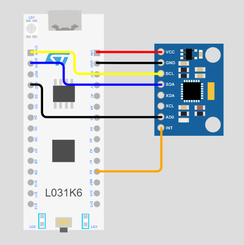

Figure 3 demonstrates a complete physical interface mapping. An I2C sensor module is connected to the STM32 Nucleo-L031K6 board using these primary hardware lines:
  • I2C1_SCL (PB6 / D1)
  • I2C_SDA (PB7 / D0)
  • External hardware interrupt line PA0 (A0)
  • Address grounding (AD0)
Figure 3. Complete physical interface mapping.
