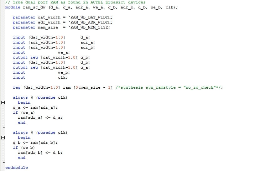

Description
This is a wishbone B3 compliant RAM memory. The memory array is defined as a 32 bit memory. This gives two valuable benefits. First. memory array can be mapped into one block RAM with no need for byte select during synthesis. Second, memory content can be initialized with CPU instructions with no need to split content into byte chunks.
