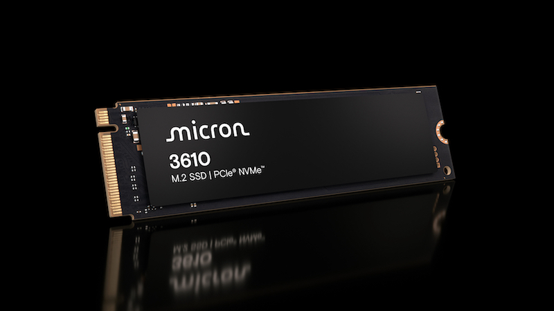

Micron 3610 SSD
Micron calls the 3610 SSD the "world’s first Gen5 G9 QLC client SSD." Image used courtesy of Micron
The 3610 boasts up to 11,000 MB/s sequential reads and 9,300 MB/s sequential writes, with up to 1.5 M random read IOPS and 1.6 M random write IOPS. The 3610’s form factor is arguably the most consequential spec for OEM design teams; Micron says it offers the world’s only 4-TB capacity in a single-sided M.2 2230 card, aimed at ultra-thin laptops and AI-capable devices.
Micron, which recently announced the closure of its Crucial consumer business, is leaning incredibly hard on efficiency with the 3610, which uses a DRAM-less architecture with host memory buffer support and DEVSLP low-power states. Micron says this architecture improves performance per watt by 43% compared to Gen4 TLC in its own comparisons. The company also cites user-facing gains, including up to 30% better scoring and 28% higher bandwidth than Gen4 QLC SSDs in PCMark 10 testing. Micron also claims it can load a 20-billion-parameter AI model in under three seconds.

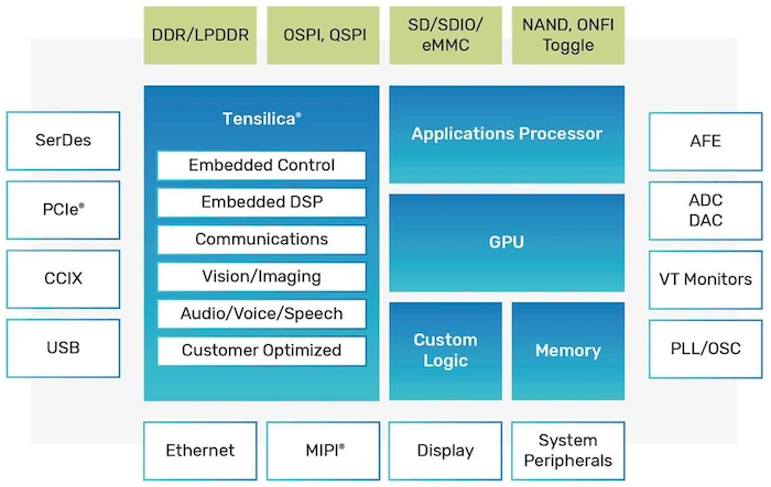

Overview of Cadence's memory and storage IP solutions
Overview of Cadence's memory and storage IP solutions. Image used courtesy of Cadence
RAIDDR is described as a next-generation ECC algorithm that achieves close to single-device data correction (SDDC) with minimal logic overhead, delivering protection equivalent to symbol-based ECC typically used in DDR5 RDIMM-class implementations. Cadence says the solution offers sideband ECC performance comparable to traditional DDR5 ECC implementations while preserving LPDDR5X PPA in a compact form factor.
Cadence’s feature list details support for 40-bit channels using LPDDR5X DRAM, sideband ECC for maximum channel bandwidth, and the 9600-Mbps data rate target. The design target is clearly stated as AI training and inference infrastructure, where memory, power, and reliability frequently serve as system-level constraints.

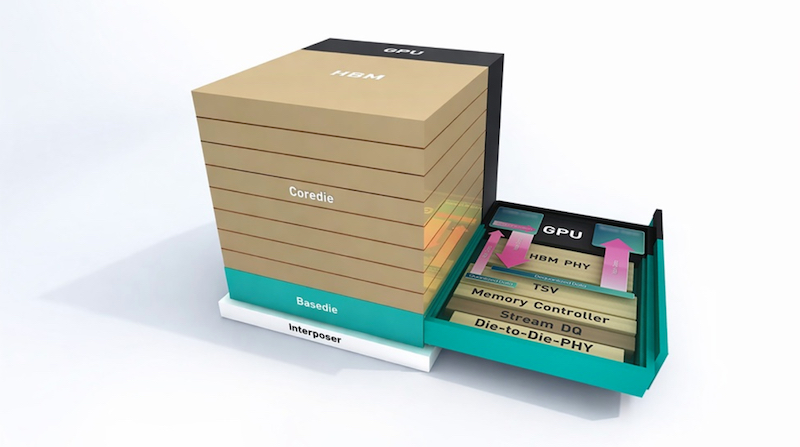

SK Hynix's Custom HBM (cHBM)
SK Hynix's Custom HBM (cHBM). Image used courtesy of SK Hynix
SK Hynix also set up an "AI System Demo Zone" at CES, where visitors could test the company's concepts to reduce data movement. That included custom HBM (cHBM), which shifts some functions to the HBM base die, cutting transfer power and facilitating processing in memory. SK Hynix also demonstrated a prototype accelerator card based on its GDDR6 AiM concept, along with compute-enabled CXL memory module ideas for pooled memory expansion.
