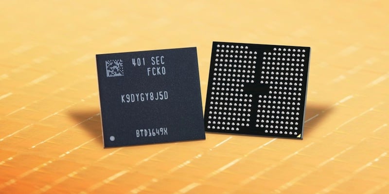

Kicking off this roundup, Samsung recently announced the mass production of its 9th-generation vertical NAND (V-NAND) solution. Vertical memory solutions have become increasingly popular as developers reach the fundamental limits of packing more bit density in shrinking package sizes.
Samsung's new 9th-gen V-NAND offers up to 1 TB of total storage with a triple-level cell architecture. In this architecture, three bits of information can be stored in a single cell, improving storage density and slightly degrading speed compared to single- and multi-level cell architectures.
Samsung V-NAND solution
Samsung used channel hole etching technology in its new V-NAND solution, which allows holes to span a wider number of layers. Image used courtesy of Samsung
Samsung reports that the 9th-gen V-NAND offers a 50% improvement in bit density compared to previous generations and up to 3.2 Gbps data input/output speeds. The chips use Samsung’s channel hole etching process technology, increasing density and the number of layers. Coupled with 10% lower power consumption, Samsung’s newest V-NAND targets the high-performance SSD market.

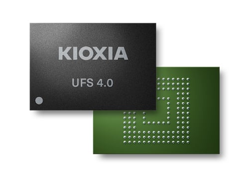

Switching to embedded applications, Kioxia has recently announced it has begun sampling its latest Universal Flash Storage (UFS) 4.0 embedded Flash memory devices. Available in capacities from 256 GB to 1 TB, the UFS 4.0 devices offer many benefits to embedded and mobile designers.
Compared to the legacy UFS 3.1 devices, UFS 4.0 improves read/write speeds by up to 50% and reduces overall size, allowing designers to integrate storage in smaller devices. In addition, the devices have a theoretical transfer speed of 46.4 Gbps and provide superior performance when data speeds are crucial.
The latest Kioxia storage device
The latest Kioxia storage device reduces size and improves density, allowing embedded applications to take advantage of more storage. Image used courtesy of Kioxia
The Kioxia devices use a TLC architecture along with its BiCS FLASH memory technology, allowing for size reduction and density improvements. The sampling for the 256 and 512 GB chips will begin this month, with the 1 TB chip sampling beginning in June 2024.
