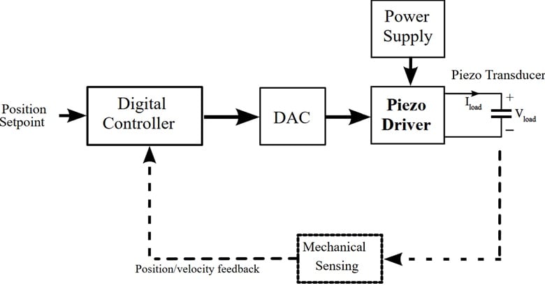

Figure 1 depicts the typical placement of a piezo driver in a precision positioning system.
Typical placement of a piezo amplifier in a mechanical positioning system.
Figure 1. Typical placement of a piezo amplifier in a mechanical positioning system.
The purpose of the driver is to generate an electrical signal for its piezo load. Because there is a close relationship between the applied charge and the mechanical deformation of a piezo device, the most suitable driver is a charge amplifier.
The problem is that piezo devices behave capacitively. This results in a quasi-linear relationship between charge and voltage. In this article, we assume a voltage-to-voltage piezo amplifier with a low-power input voltage (e.g. from a DAC) that is linearly amplified to an output voltage.
The designer should verify whether a voltage amplifier is suitable for the application. Especially in cases without mechanical feedback, the nonlinear Q-V relationship of the piezo load can negatively affect accuracy when a piezo voltage driver is used.

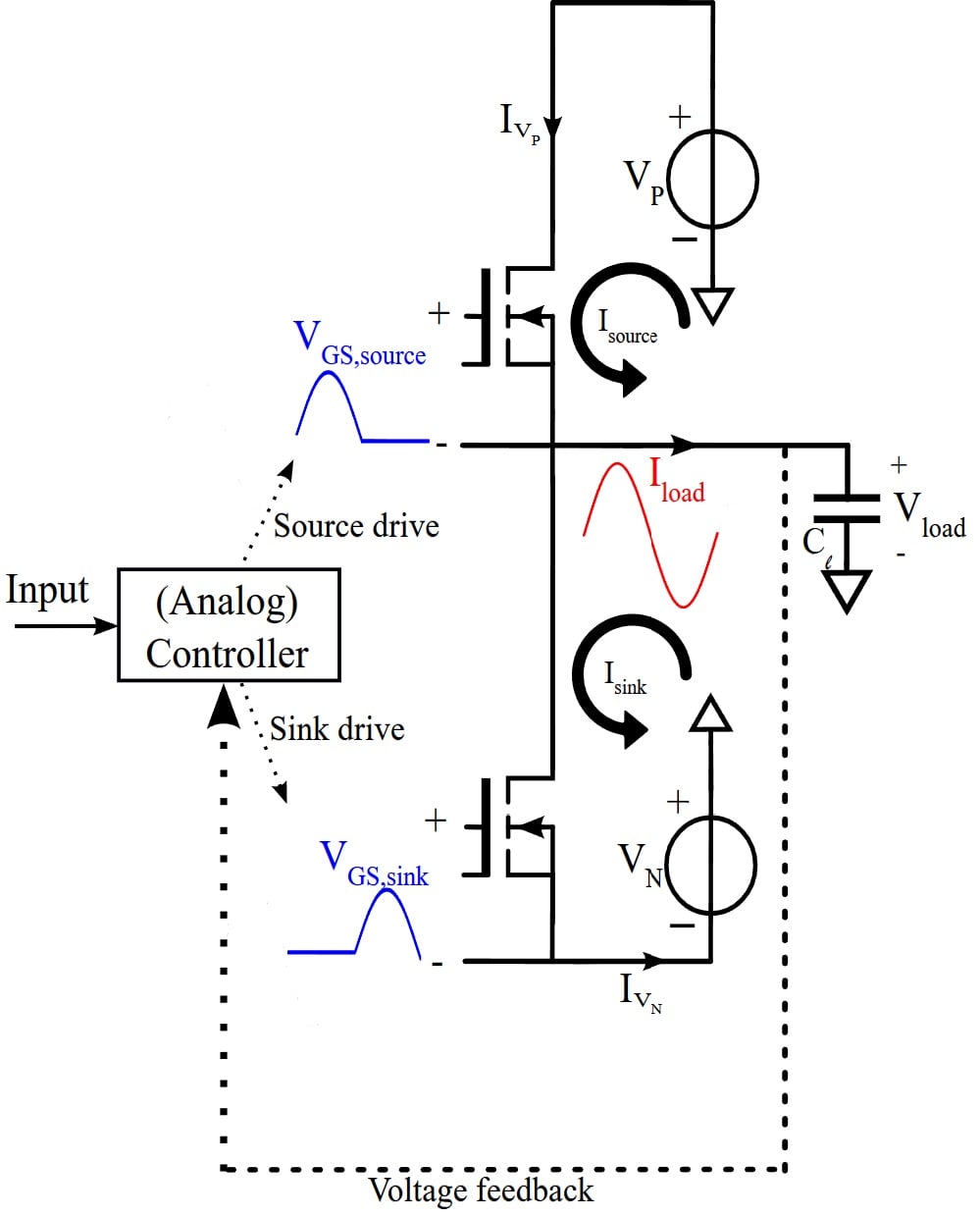

Now that we have some background, let's examine the Class AB driver. The circuit diagram for a Class AB output stage with a capacitive piezo load is shown in Figure 2.
Push-pull Class AB output stage used in a voltage feedback amplifier with capacitive piezo load.
Figure 2. [click to enlarge] Push-pull Class AB output stage used in a voltage feedback amplifier with capacitive piezo load.
This widely used push-pull configuration is similar to the output stage of an op amp. The "push" side, which is the top half, is active when the positive supply (VP) provides a positive current to the load. The "pull" side in the bottom half is active when the load discharges current to the negative supply (VN).
If this were the end of the story, Figure 2 would be a Class B amplifier. In reality, there will be a quiescent current flowing from positive to negative supply, adding a Class A component to the output stage. The circuit is therefore a Class AB configuration.
The configuration in Figure 2 has two NMOS transistors. These MOSFETs operate in the saturation region. The push-stage NMOS has its source connected to the load. Driving the push-stage NMOS with a low-voltage gate-source signal will therefore require an isolated gate driver.
Note that the complete piezo driver typically consists of multiple stages and a voltage feedback loop. Although we are only considering the output stage in this article, all of these stages are important to the bandwidth and distortion performance of the driver.

To understand the operation of the Class AB output stage, let's take a step back and discuss the Class B component. An ideal Class B output stage that is periodically driving a capacitive load (Cl) at peak voltage will consume a total power of:
$$P_{Class~B}~=~C_l~\times~(V_P~+~|V_N|)^2~\times~f_{fpbw}~=~C_l~\times~(V_{pp,max})^2~\times~f_{fpbw}$$
Equation 2.
where:
VP is the positive supply
VN is the negative supply
ffpbw is the full-power bandwidth
Vpp,max is the maximum peak-to-peak signal voltage.
A maximum power efficiency of 78% for Class B operation is often cited in literature. While this is true for resistive loads at peak voltage, it doesn't at all apply to reactive (piezo) loads. After all, the ideal piezo load is a lossless, reactive element. Under periodic excitation, the load capacitance does not consume net power.
Even an ideal Class B amplifier has a power efficiency of zero when its load is purely reactive. The energy returning from the load gets dissipated as heat in the transistors of the Class B output stage.
This is caused by the "push" stage only being able to source current and the "pull" stage only sinking current, in both cases resulting in the power supplies never absorbing power. In other words, the active stage will have a transistor with both drain-source current (IDS) and drain-source voltage (VDS) being non-zero when the load draws current.
Whether this wasted power turning into heat is a problem depends on the application. Some piezo applications require very small, precise movements around an operating point that changes only slowly. Dynamic operation of a Class B push-pull stage at peak-to-peak voltage Vpp and frequency f results in a smaller power consumption:
$$P_{Class~B,~small~excursion}~=~C_l~\times~(V_P~+~|V_N|)~\times~V_{pp}~\times~f$$
Equation 3.
For large-stroke (high Vpp) at fast rate (high f) applications, the power consumption can lead to meaningful design challenges. Even if electrical power is not a scarce resource, the dissipated heat can create thermal management issues. As an example, full excursion of a piezo load Cl = 4 μF between the positive supply VP = 150 V and the negative supply VN = –150 V at a full-power bandwidth ffpbw = 1 kHz results in a power of 360 W!
Even if bulky heat sinks or convective cooling are feasible, the thermal resistance between the junction and the case of the transistors needs to be carefully considered. It may require multiple (stacked) transistors. Thermal connection of the PCB to the heat sink is also an essential consideration.
So far, we have only considered Class B operation. In reality, there will be an overlap between the source and sink phase. This overlap requires a signal-independent quiescent current (IQ) flowing between the positive and negative power supplies. This Class A component improves the amplifier's crossover distortion behavior, at the cost of increased power consumption:
$$P_{quiescent}~=~(V_P~+~|V_N|)~\times~I_Q$$
Equation 4.
If there are constraints on size or mass, a Class AB (or Class B) amplifier might not be a viable choice.

In Quadrants 2 and 4, power is absorbed. Not all power supplies are capable of this. Fortunately, the Class AB output stage for piezo loads does not impose special requirements on its power supply, save for the following:
  • The supply must be able to deliver more current than the maximum required load current.
  • The supply's DC voltage levels must be compatible with the required voltage swing.
Going back to Figure 2, a load source current (Iload > 0) is always delivered by the positive supply (Quadrant 1 operation). A load sink current (Iload < 0) is delivered by the negative supply (Quadrant 3 operation). In other words, because energy returning from the reactive load is dissipated in the output stage's transistors, power supplies never have to absorb power or act as a load (Quadrant 2 / Quadrant 4 operation).
