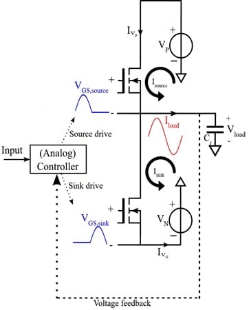

Figure 2 shows the Class D topology introduced in the second article.
Class D half-bridge output stage.
Figure 2. [click to enlarge] Class D half-bridge switching output stage, used in a voltage feedback amplifier with capacitive piezo load.

The popularity of the Class D output stage mostly stems from its power efficiency. However, the source of this efficiency also causes a peculiar difficulty in systems with reactive loads. This problem comes down to the need for one or more power supplies that can both deliver and absorb power.
This fundamental need is often overlooked and is best explained with an example. Imagine a positive load current (Iload) and inductor current (ILf). While the high-side circuit is conducting, the current through the positive power supply (IVP) is positive. This requires VP to deliver power.
When the output stage switches to the low-side circuit conducting current, the inductor current stays roughly the same. The inductor current is still positive, but now flows through the negative supply. Therefore, IVN is negative. Current is now flowing from the positive to the negative terminal of the negative supply (VN). The negative supply needs to absorb power rather than provide it.
This power absorption requirement can be partly circumvented by means of a full-bridge configuration with a single positive power supply. Throughout one PWM period, power is then delivered and absorbed by the same power supply terminal and can be smoothed with decoupling capacitors. For resistive loads, which only have net power dissipation, this works without further issues, and no bidirectional power supply is needed.
For capacitive loads, the story unfortunately does not end with this simple countermeasure. Referring back to Figure 2, imagine a positive load voltage (Vload) and a negative load current (Iload), or a negative Vload and positive Iload. In both cases, energy gets returned from the load to one of the power supplies through a negative IVP or negative IVN.

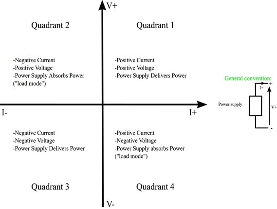

Figure 3 provides an overview of the power supply operating modes with quadrant conventions.
Power supply operating modes with quadrant conventions.
Figure 3. Operating modes of power supplies. In Q2 and Q4, power is absorbed. Not all power supplies have this ability.
In short, a Class D output stage in half-bridge configuration requires two power supplies to cover all four operational quadrants in Figure 3. For a full-bridge configuration, a positive power supply operating in Quadrant 1 (power delivery) and Quadrant 2 (power absorption) suffices.
