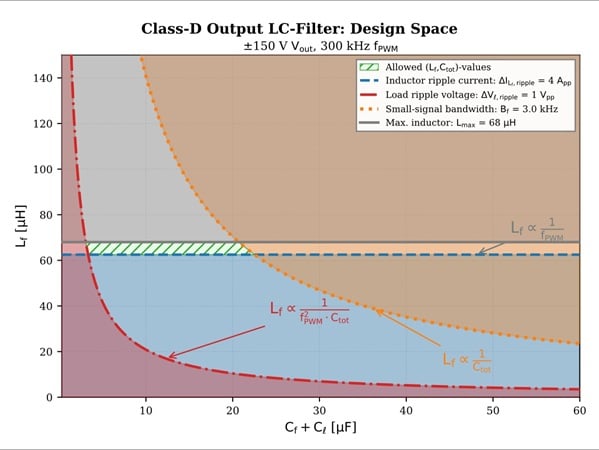

A Visual Representation of the Design Space
The benefits of this design approach are best illustrated visually. We fill in some realistic values:
  • Source voltage of VS = 150 V.
  • PWM switching frequency of fPWM = 300 kHz.
  • Maximum allowed inductor current ripple of ΔILf,ripple, required = 4 A (peak-to-peak).
  • Maximum allowed output voltage ripple of ΔVl,ripple,required = 1 V (peak-to-peak).
  • Small-signal bandwidth of Bf = 3 kHz.
  • Maximum inductor value of Lmax = 68 μH.
The inequalities in Equations 5 through 7 then turn into allowed design regions in the two-dimensional LfCtot plane, as shown in Figure 2.
Lf vs. Ctot design space for a PWM frequency of 300 kHz.
Figure 2. [click to enlarge] Design space in the 2D LfCtot-plane for fPWM = 300 kHz.
In the above figure, the solid-colored areas are forbidden design regions. The intersection of allowed regions is hatched in greens. This green-hatched region represents the Lf Ctot-pairs where the ripple and bandwidth will be within the requirements.
Depending on the requirements and parameters (Vs, fPWM, and Lmax come to mind) the allowed region can be larger, smaller, or not exist at all. In the latter case, the requirements are not feasible for the chosen parameters.

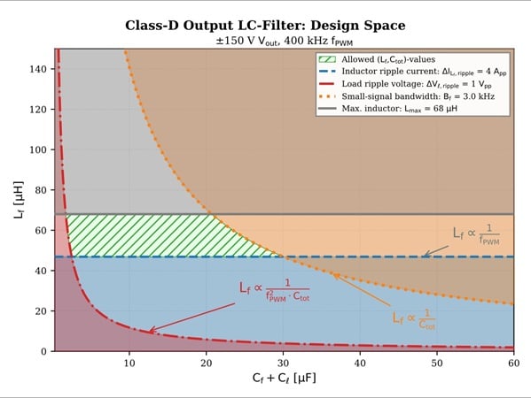

Figure 3 shows how the allowed design region can be broadened by increasing fPWM from 300 kHz to 400 kHz. Increasing fPWM is beneficial to residual ripple, but poses new challenges for electromagnetic interference (EMI) design, component selection, and possibly power consumption as well.
Lf vs. Ctot design space for PWM switching frequency of 400 kHz.
Figure 3. [click to enlarge] Design space in the 2D LfCtot-plane for fPWM = 400 kHz.
Once an inductor value (Lf) inside the allowed region is chosen, Figures 2 and 3 also show the compliance range of Ctot = Cf + Cl. If a large range of load capacitances needs to be accommodated, a designer might be forced to put a small filter capacitance in parallel with the load, to decrease the load ripple current for small piezo loads.
This will, however, limit the maximum load current for small piezo loads, which in turn limits the slew rate.
