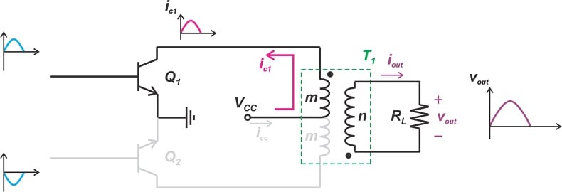

The two transistors (Q1 and Q2) operate on alternating half-cycles. To drive these two transistors, we need to have both the input signal and its polarity-inverted version. Notice that both transistors are NPN types.
The power supply (VCC) is connected to the center tap of the transformer. With the waveforms shown, transistor Q1 is driven into conduction during the first half-cycle. In this half-cycle, transistor Q2 remains off. When Q1 is on and Q2 is off, the circuit can be simplified to the one shown in Figure 3.
Diagram of a transformer-coupled push-pull amplifier during Q1's on-period.
Figure 3. Transformer-coupled push-pull amplifier when Q1 is on and Q2 is off.
In Figure 3, transistor Q1 draws a collector current (ic1) from VCC. As indicated by the transformer dot convention, the current in the secondary of the transformer flows into RL. This produces the positive half-cycle of the output voltage.
