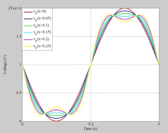

Figure 2, which is also taken from the previous article, illustrates how vF changes if we incorporate different levels of the third-harmonic component.
Class F collector voltage waveforms with different values of A3/A1.
Figure 2. Class F collector voltage for A1 = Vcc = 1 V and values of x varying from 0 to 0.25.
As we increase x from zero to about 0.1, the total voltage becomes flatter around its peaks and troughs. However, as x exceeds 0.1, some ripples appear in the waveform. In this article, we’ll keep things simple by designing for the flattest possible waveforms.
