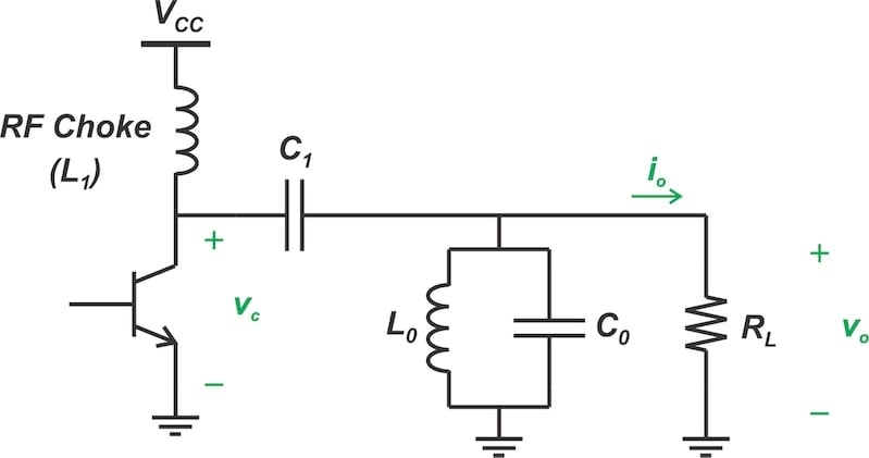

This configuration is known as the third-harmonic-peaking Class F amplifier. For comparison purposes, Figure 2 shows the circuit diagram for a single-transistor Class B amplifier.
Circuit diagram for a single-transistor Class B amplifier.
Figure 2. A single-transistor Class B amplifier.
As you can see, the two circuits are quite similar. The only difference is the inclusion of a second resonant circuit. Class F amplifiers shape their voltage waveforms by employing multiple resonant circuits tuned to the signal’s harmonics. The multi-resonant load network keeps the voltage across the transistor low when the current through the transistor is high, producing a square wave.
