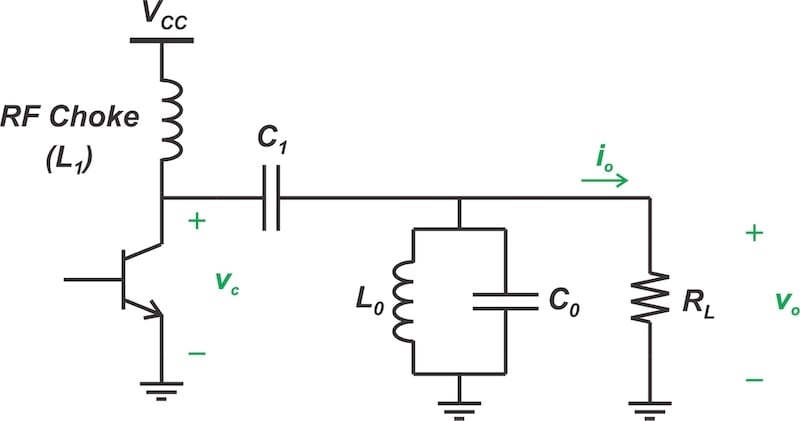

We’ll start by considering some unshaped waveforms. If we remove the L2-C2 harmonic resonator from Figure 1, what’s left is essentially a single-transistor Class B amplifier (Figure 4).
A single-transistor Class B stage.
Figure 4. A single-transistor Class B stage.

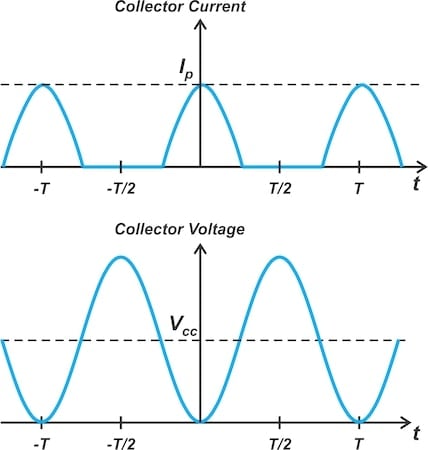

With no harmonics incorporated, the collector voltage of the Class B stage is an offset sinusoid. This is illustrated, along with the ideal collector current, in Figure 5.
Ideal Class B collector voltage and current waveforms.
Figure 5. The collector current (top) and voltage (bottom) for an ideal Class B stage.
