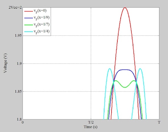

Voltage swing for a new, higher, value of x.
Figure 3. The zoomed-in view of the total collector voltage for A1 = Vcc = 1 V and x = 0, 1/9, 1/7, and 1/4.
Once again, increasing the value of x results in a peak that surpasses that of the maximally flat waveform. This confirms that an optimal value for x must exist that maximizes the efficiency, and that this value is greater than 1/9 (the value for the maximally flat waveform).
