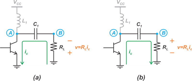

Figure 2 shows two AC equivalent circuit models: one in which the transistor sinks an AC current of ic, and one in which the transistor sources the same AC current.
Two equivalent circuit models of an example amplifier. In one model, the transistor sinks an AC current. In the other, it sources the same current.
Figure 2. Two equivalent circuit models of an inductively-loaded common-emitter amplifier. In Figure 2(a), the amplifier’s transistor sinks an AC current. In Figure 2(b), the transistor sources an AC current.
In Figure 2(a), the AC voltage at node B is –RLic. With C1 acting as a short circuit, the AC voltage at node A is also –RLic. When we account for both DC and AC components, we observe that the overall voltage at node A goes from VCC to a smaller value of VCC – RLic.
In Figure 2(b), the transistor sources an AC current of ic, and a positive AC voltage appears at node A. In this case, the overall voltage at node A goes from VCC to a larger value of VCC + RLic. We see from this that the collector voltage can exceed VCC.
Another way to reach the same result is to consider the DC voltage across the capacitor C1. In the absence of an AC signal, the nodes A and B in Figure 3 are at VCC and 0 V, respectively. The DC voltage across the capacitor is therefore VCC, with the polarity shown in Figure 3.
Circuit diagram of an inductively-loaded common-emitter amplifier. Polarity changes across the capacitor.
Figure 3. A generic inductively-loaded common-emitter amplifier. Note the polarity on each side of C1.
When the transistor sources an AC current of ic, a positive AC voltage of RLic appears at node B. Accounting for the DC voltage of the capacitor, we observe that the overall voltage at node A is VCC + RLic. Similarly, when the transistor sinks an AC current of ic, the overall voltage at node A drops to VCC – RLic.

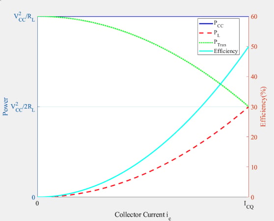

In practice, however, the achievable efficiency of the inductively-loaded PA can be well below 50%. Figure 5 illustrates how the efficiency changes with the signal amplitude—as we can see, the efficiency is 50% only when the signal swing is at its maximum.
Figure 5 also shows how the three power terms associated with this circuit change with the amplitude of the collector AC current. These three terms are:
  • Pcc: Supply power.
  • PL: Load power.
  • PTran: Transistor power.
Three power terms and power efficiency plotted versus collector current.
Figure 5. Supply power (blue), load power (red), transistor power (green), and power efficiency (cyan) plotted versus collector current.
As expected, the power provided by the supply (Pcc) is constant. This power is dissipated either in the load (PL) or in the transistor (PTran). When the load power increases, the power dissipated in the transistor drops accordingly. In the absence of an AC signal, zero power is delivered to the load, so the transistor dissipates all the power provided by the supply.
The power dissipated in the transistor gets closer to its minimum value as the signal amplitude increases. From this, we can see that the transistor used in a Class A amplifier is under the most stress when no AC signal is applied. With that in mind, let’s move on to a different version of the inductively-loaded common-emitter stage.

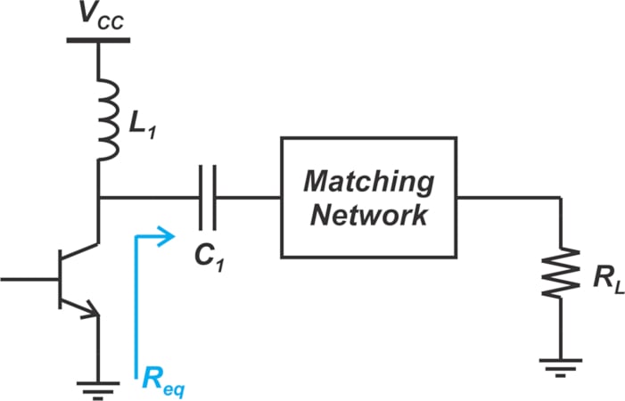

The Need for a Matching Network
Our discussion of inductively-loaded Class A power amplifiers actually began in the preceding article. Let’s go back over a few of the relevant points from that article’s concluding section:
  • Achieving maximum output power requires a specific relationship between RL and the bias point of the transistor. This relationship is described in Equation 1 of this article, as well as Equations 3 and 4 of the last one.
  • If a given load resistance doesn’t satisfy the above condition, we can use a matching network to transform the actual load (RL) to the optimum load (Req), as shown in Figure 6.
  • Matching networks are almost always implemented using reactive components. As a result, the power delivered to the input of the matching network is dissipated in RL.
Circuit diagram of an inductively-loaded common-emitter amplifier that includes a matching network.
Figure 6. An inductively-loaded common-emitter amplifier that includes a matching network.

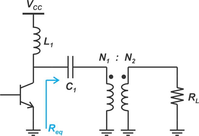

One common way to implement the matching network is to use a transformer, as illustrated in Figure 7.
Diagram of an inductively-loaded common-emitter PA that includes a transformer.
Figure 7. An inductively-loaded common-emitter amplifier that uses a transformer as a matching network.
In the above figure, we have:
$$R_{eq} ~=~ \big ( \frac{N_1}{N_2} \big )^2 R_L$$
Equation 5.
where N1 and N2 are the turns, meaning the number of windings on each side of the transformer. By using an appropriate turns ratio, we can make the load resistance RL appear either larger or smaller at the collector, as needed.
The following example, inspired by a problem from “RF Microelectronics” by B. Razavi, should help you better understand how the transformer can change the power transistor’s maximum voltage and current requirements.
Example: Finding the Turns Ratio of a Transformer
We intend to use the circuit in Figure 7 to deliver 4 W to a 50 Ω load. If the supply voltage is 2 V and the circuit operates at its maximum efficiency, what is the required turns ratio for the transformer?
To determine this, we first find the equivalent load resistance (Req) that maximizes the output power. Applying Equation 2 with Req as the load resistance of the stage, we obtain:
$$P_{L,max} ~=~ \frac{V_{CC}^2}{2R_L} ~\Rightarrow~ 4~=~\frac{2^2}{2R_{eq}}$$
Equation 6.
which results in Req = 0.5 Ω. Having RL and Req, we can now use Equation 5 to find the required turns ratio:
$$0.5 ~=~ \big ( \frac{N_1}{N_2} \big )^2 ~\times~ 50 ~\Rightarrow~ \frac{N_2}{N_1}~=~10$$
Equation 7.
Delivering 4 W to a 50 Ω load requires:
Due to the transformer’s operation, the peak-to-peak voltage swing at the collector is 40/10, or 4 V, which is theoretically possible with a 2 V supply. However, ic,max = 0.4 × 10, making the peak AC collector current 4 A!
When the collector voltage is at its minimum, the transistor sinks twice ic,max. Therefore, 8 A is the maximum current that the transistor in this example can carry without being damaged.
