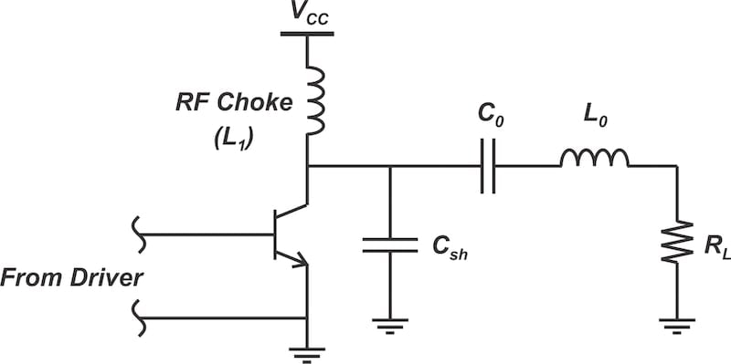

Figure 1 shows the basic topology of a Class E stage.
Schematic of a basic Class E amplifier.
Figure 1. Schematic of a basic Class E amplifier. Image used courtesy of Steve Arar
To determine the component values for this circuit, we use the design equations presented earlier in this article series. Though Class E amplifiers are somewhat resilient to changes in circuit parameters, we should still plan on tuning the component values to obtain optimum performance. Figure 2 contrasts the typical switch waveforms for properly tuned and mistuned amplifiers.

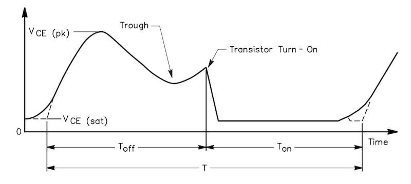

Variations in Circuit Parameters Change the Switch Voltage Waveform
For an improperly tuned amplifier, the voltage across the switch has a peak and a trough, as depicted in Figure 4.
Typical switch voltage waveform observed in an improperly tuned amplifier.
Figure 4. Typical switch voltage waveform for an improperly tuned amplifier. Image used courtesy of N. O. Sokal
The location of the trough changes in a predictable way if we change the values of the following circuit components:
  • The shunt capacitor (Csh).
  • The capacitor of the RLC circuit (C0).
  • The inductor of the RLC circuit (L0).
  • The load resistor (RL).

Step 3: Find the Trough and Adjust the Capacitances
Next, we find the trough of the voltage waveform. Based on the position of the trough, we then adjust Csh and C0. For example, consider the mistuned switch voltage waveform in Figure 6. The vertical arrow in this figure points to the transistor turn-ON instant.
Switch voltage turn-ON in a mistuned amplifier.
Figure 6. Switch voltage turn-ON in a mistuned amplifier. Image used courtesy of N. O. Sokal
To match the optimum waveforms, the trough of this waveform must move downwards and to the left. Referring back to Figure 5, we observe that we need to decrease Csh for this to occur.
In the above example, note that the trough of the waveform is actually hidden from view due to the chosen component values. The switch actually turns ON before the voltage across the shunt capacitor can reach the trough. In cases when the trough isn’t observable, we can estimate its location by visually inspecting the waveform.
