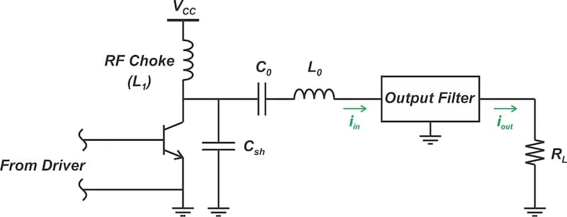

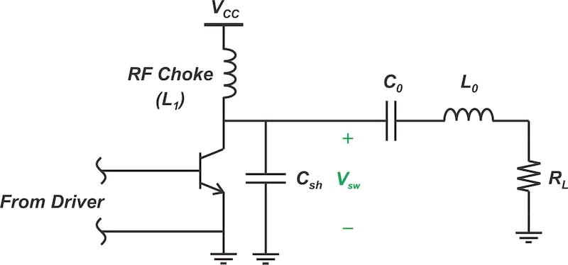

The practical range of Q is from 3 to 10, which isn’t high enough to prevent harmonic currents from flowing into the load. Figure 1 shows a basic Class E amplifier—to provide the required degree of harmonic suppression, we need to insert a filter between its series resonant circuit and its load.
Schematic of a basic Class E amplifier.
Figure 1. Schematic of a basic Class E amplifier. Image used courtesy of Steve Arar

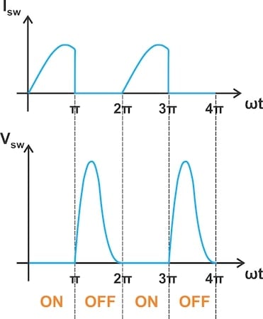

Figure 2 shows the typical switch waveforms for a Class-E driven transistor.
Typical switch current and voltage waveforms for a Class E amplifier.
Figure 2. Typical switch current (top) and voltage (bottom) waveforms in a Class E amplifier. Image used courtesy of Steve Arar

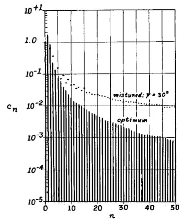

His analysis leads to the spectrum shown in Figure 3. Note that the values of cn in this figure are normalized to the supply voltage. Put a different way, it assumes Vcc = 1.
The spectrum of voltage across a Class-E driven switch.
Figure 3. The spectrum of the voltage across a Class-E driven switch. Image used courtesy of F. Raab
In an optimum Class E amplifier, the amplitudes of the harmonic components decrease with 1/n2. The amplitudes of the first five harmonic components are given in Table 1 along with the gain in decibels.
Table 1. The amplitudes of an optimum Class E amplifier’s first five harmonic voltage components. Data used courtesy of N. O. Sokal
n 1 2 3 4 5
cn 1.6390 0.8477 0.2222 0.1432 0.0800
cn in dB 0 –5.73 –17.36 –21.17 –26.23
As an aside, the harmonic components of a mistuned amplifier reduce at a slower rate of 1/n. This is illustrated by the dotted line in Figure 3.

For an optimum Class E amplifier with Q = 5, the second and third harmonics of the load current are 19.85 dB and 35.92 dB lower than the fundamental component, respectively. Acceptable harmonic levels for a radio transmitter would be in the range of 60 dB below the carrier signal. To achieve these levels, we need to implement extra filtering before the load. This is illustrated in Figure 4.
Schematic of a Class E amplifier with an added output filter.
Figure 4. Class E amplifier with an added filter. Image used courtesy of Steve Arar
But how much extra filtering? In the next section, we’ll determine how much attenuation the filter must provide to suppress the harmonics to an acceptable level.
