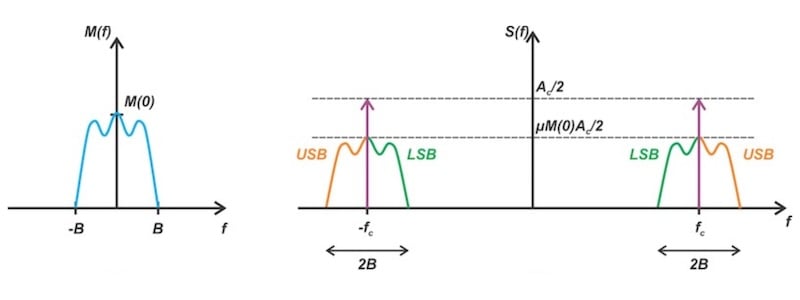

In the above equation, Ac is the carrier amplitude, m(t) is the message signal, and μ is called the modulation index. Figure 1 shows a typical output spectrum for this type of amplitude modulation.
The spectrum of the baseband signal (a) and the conventional AM signal (b).
Figure 1. The spectrum of the baseband signal (a) and the conventional AM signal (b).

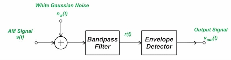

Like the DSB-SC method, the output spectrum includes two replicas of the baseband spectrum translated in frequency by ±fc. However, unlike the DSB-SC method, the conventional AM’s spectrum includes two delta functions weighted by the factor 0.5Ac. In both DSB-SC and conventional AM, the transmission bandwidth is twice that of the message signal BT=2B. Demodulation of conventional AM signals requires the use of an envelope detector. Figure 2 presents the basic model of an AM receiver employing this technique.
Figure 2. Block diagram of an AM receiver with envelope detection.
We now proceed to examine how the envelope detector affects both the input signal and the accompanying noise.

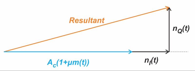

where nI(t) and nQ(t) are the in-phase and quadrature components of noise, both measured with respect to the carrier wave Ac·cos(ωct). The phasor representation below illustrates how these signal components combine to form the noisy signal.
Figure 4. Phasor representation of a noisy AM signal.
The output of the receiver is simply the envelope of the resultant signal. Because an ideal envelope detector doesn’t respond to changes in input phase, the phase of the noisy signal can be ignored. Using the phasor diagram, the noisy signal’s envelope y(t) is obtained as:

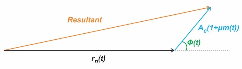

The analysis above was carried out under the assumption that the average noise power is small compared to the carrier power at the envelope detector input. When this assumption doesn’t hold, the analysis becomes substantially more complex. While the detailed analysis is outside the scope of this article, we’ll nevertheless outline a few of its results. Figure 5 illustrates the phasor representation of a noisy AM signal with high noise relative to the carrier.
Figure 5. Phasor representation of a noisy AM signal when the noise is
strong relative to the carrier.
Figure 5. Phasor representation of a noisy AM signal when the noise is strong relative to the carrier.
In the diagram above, rn(t) represents the envelope of the noise and ϕ(t) is its phase. As observed, the noise vector, which is the dominant component, is chosen as the reference. Therefore, the signal component Ac·(1+μm(t)) is rotated by ϕ(t) to account for the phase difference between noise and signal. Assuming the noise is significantly stronger than the carrier, the phasor representation can be used to approximate the envelope of the noisy signal as follows:
$$y(t) \approx r(t) + A_c \big [1 + \mu m(t) \big ] cos[\phi(t)]$$
Equation 21.
As seen, the output doesn’t contain the message scaled by a constant but instead multiplied by cos[ϕ(t)]. Because the phase of the narrowband noise, ϕ(t), is uniformly distributed over 2π radians, the message information is lost at the envelope detector's output. Mathematical analysis reveals that as the carrier‑to‑noise ratio (CNR) falls below about 10 dB, the envelope detector’s SNR decreases at a rate exceeding that of the high‑CNR regime.
This behavior is termed the threshold effect. For this reason, conventional AM systems are typically operated above the CNR threshold to prevent significant degradation in SNR. For a more detailed discussion of the threshold effect in conventional AM, see Section 2.12 of Communication Systems (4th edition) by Simon Haykin.
