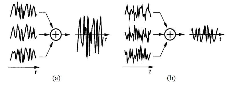

When two signals of the same frequency are combined, the resulting power depends on whether they are deterministic or statistically independent. Consider first the simple case of two coherent, phase‑aligned signals, for example x(t) = y(t) = A·cos⁡(ωct). Adding these signals produces 2A·cos⁡(ωct). In this situation, the amplitude is doubled, resulting in a fourfold increase in power relative to each component, since power scales with the square of the amplitude.
In contrast, if the two signals are statistically independent, their powers add rather than their amplitudes, resulting in a total power that is only twice that of each component. Suppose x(t) and y(t) are two statistically independent random signals. The average power of their sum is given by:
$$\begin{eqnarray} P_{tot} &=& \lim_{T \rightarrow \infty} \frac{1}{T} \int_{-T/2}^{T/2} [x(t) + y(t)]^2 \ dt \\ &=& \lim_{T \rightarrow \infty} \frac{1}{T} \int_{-T/2}^{T/2} [x^{2}(t) + y^{2}(t) + 2x(t)y(t)] \ dt \end{eqnarray}$$
Equation 1.
The time averages of x2(t) and y2(t) clearly correspond to the average powers of the input signals. But what does the third term in the integral represent? The final term represents the correlation between the two signals, reflecting the degree of similarity between them. For statistically independent signals, the correlation is zero, so the last term vanishes. In this case, the total power is simply the sum of the individual powers. This contrasts with the coherent, phase‑aligned signals, which yielded a fourfold increase in output power when combined.
Formally, for statistically independent functions, the average of their product equals the product of their averages. If the signals are zero‑mean, the cross‑term disappears, and the output power is simply the sum of the individual powers. Figure 1 helps you visualize how combining correlated, phase‑aligned signals yield greater output power compared to uncorrelated signals.
Figure 1. Combining correlated, phase-aligned signals (a) yields
higher output power compared to uncorrelated signals (b). Image used courtesy of
B. Razavi.
Figure 1. Combining correlated, phase-aligned signals (a) yields higher output power compared to uncorrelated signals (b). Image used courtesy of B. Razavi.
Having established how coherent and incoherent signals combine, we’re now prepared to examine the noise performance of the DSB‑SC coherent detector.

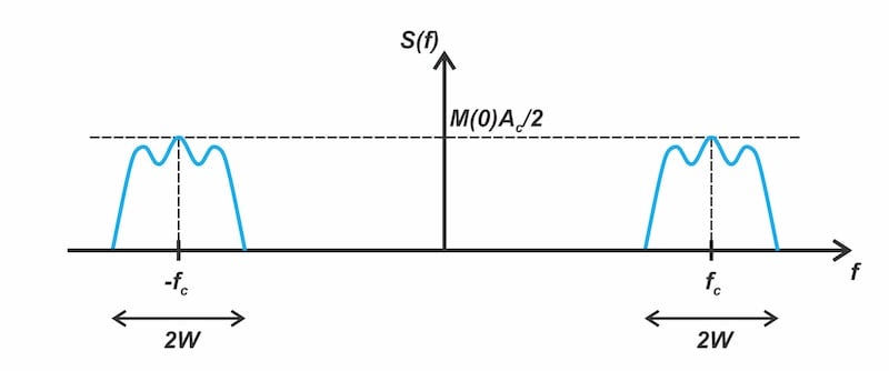

An important concept, which provides the foundation for understanding the modulated signal’s spectrum and the subsequent noise analysis in this article, is how multiplication by cos⁡(2πfct) transforms the signal’s spectral content.
When a spectral component at frequency f1 is multiplied by cos(2πfct), the result is two new frequency components at f1±fc. Each new component inherits half the amplitude of the original, and thus carries one-fourth of its power. Therefore, the frequency spectrum of the modulated signal s(t) is as shown in Figure 3.
Figure 3. Typical spectrum of a DSB-SC signal.

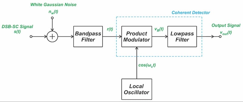

To demodulate s(t), the receiver multiplies it by a locally generated carrier wave cos⁡(2πfct) that is phase-coherent with the original carrier used in the transmitter. Shown in Figure 4 is the basic block diagram of a coherent detector.
Figure 4. The model of a DSB-SC receiver for coherent AM detection.
In the rest of the article, we'll explore how the output signal and noise power relate to the signal and noise power present at the demodulator’s input.

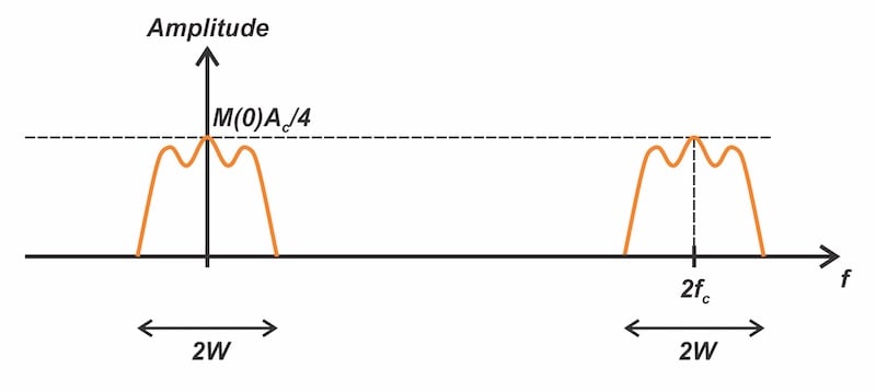

When the positive-frequency portion of s(t) shown in Figure 3 is multiplied by cos⁡(2πfct), two spectral components emerge: one centered at DC and the other around 2fc, as illustrated in Figure 5.
Figure 5. Spectrum resulting from multiplying the positive-frequency
portion of s(t) by the carrier wave.
Figure 5. Spectrum resulting from multiplying the positive-frequency portion of s(t) by the carrier wave.

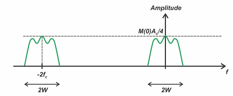

Note that the amplitude of each frequency component is scaled by a factor of 0.5. Similarly, multiplying the negative-frequency component of s(t) by the carrier wave yields the spectrum shown in Figure 6.
Figure 6. Spectrum resulting from multiplying the negative-frequency
Figure 6. Spectrum resulting from multiplying the negative-frequency portion of s(t) by the carrier wave.
The lowpass filter following the multiplier suppresses the high-frequency components around 2fc, allowing only the baseband content near DC to pass through. A natural follow-up is to ask how the baseband components in Figures 5 and 6 combine to form the output signal. We can show that the two baseband components are in phase and hence their superposition leads to an output amplitude twice that of either component alone, producing the spectrum shown in Figure 7.
