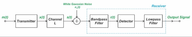

Figure 1 presents a general model of analog communication systems. This model is applicable to the analysis of noise in both AM and FM schemes.
Figure 1. Generalized model of a continuous wave (CW) communication
system used for noise analysis.
Figure 1. Generalized model of a continuous wave (CW) communication system used for noise analysis.
In the figure above, m(t) represents the message signal to be transmitted. The modulated carrier x(t) at the transmitter output is delivered to the communication channel. Except for a transmission loss of L, the channel behaves nearly ideally, introducing negligible distortion and delay.
The detector block in the receiver performs demodulation. Its configuration varies depending on the modulation scheme and the specific demodulation technique chosen for that scheme.
When a channel introduces distortion, the receiver must employ a bandpass filter with an appropriate response for equalization. The equalization filter must be placed before the detector, since demodulation is often nonlinear. The notable exception is AM synchronous detection, which operates linearly and permits equalization to happen at baseband.
While the channel is assumed to be distortionless, it's perturbed by noise. In Figure 1, the term nw(t) represents the channel noise. It is modeled as additive white Gaussian noise with a zero mean and a double-sided power spectral density (PSD) of N0/2 W/Hz.
The signal at the channel output, s(t), is simply added to nw(t). The resulting composite signal is then processed by the receiver.
The bandpass filter at the receiver front end is sometimes called the carrier filter. This filter is assumed to have a unity-gain rectangular response and a bandwidth equal to the modulated wave's transmission bandwidth (BT).
For simplicity, we use the bandpass filter to represent the entire predetection chain, which encompasses the RF and IF amplification and filtering stages within the receiver. Frequency translation and gain prior to detection are neglected in this model because they affect signal and noise equally.
Note that nw(t) can also account for thermal noise generated within the receiver's predetection components, including the RF amplifier and subsequent IF stages. This internal noise is also modeled as additive white noise over the signal bandwidth. When including the noise from pre-detection stages, noise contributions from IF stages and mixers are typically secondary. The front-end RF amplifier provides sufficient gain to render subsequent noise sources negligible in the overall noise profile.

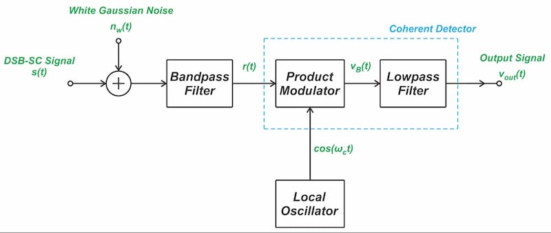

To evaluate the noise performance of modulation schemes, we model all significant noise sources as additive white noise at the receiver input. The attention is centered on the receiver portion of the block diagram in Figure 1. For example, Figure 2 depicts the model we use for a coherent DSB-SC demodulator.
Figure 2. The model of a DSB-SC receiver for coherent AM detection.
In this figure, s(t) is the input signal. This is a DSB-SC AM wave with a carrier frequency of fc and a transmission bandwidth of BT.
Evaluating noise performance begins with constructing a mathematical model of the system components. In coherent detection, the model comprises a sequence of filtering and multiplication operations. This model allows us to track how both the input signal and noise evolve as they propagate through each stage of the demodulator.

We'll now determine the signal-to-noise ratio (SNR) at the input of the coherent demodulator. This parameter is also known as the pre-detection SNR.
The bandpass filter has a center frequency of fc and a bandwidth of twice the message bandwidth (2W). This allows it to pass the input AM wave without introducing any distortion. Therefore, the noisy signal presented to the detector is:
