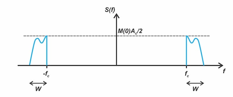

The SSB signal, with the upper sideband in use, has the typical spectrum illustrated in Figure 2.
Figure 2: Typical spectrum of an SSB signal.
Figure 2. Typical spectrum of an SSB signal.

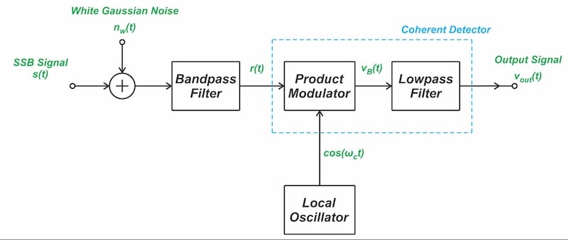

To demodulate SSB (and DSB-SC) waves, we can use the coherent detector shown in Figure 3.
Figure 3: Basic block diagram of the coherent SSB demodulator.
Figure 3. Basic block diagram of the coherent SSB demodulator.
We now turn to examining how coherent detection influences the input noise and the SSB signal.

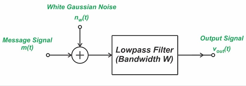

To enable meaningful comparisons across different methods, the demodulator’s output SNR is typically benchmarked against that of an equivalent baseband system. The baseband system operates without any form of modulation or demodulation. Figure 9 illustrates the basic receiver model employed in a baseband communication system.
Figure 9: Block diagram of the baseband receiver.
Figure 9. Block diagram of the baseband receiver.

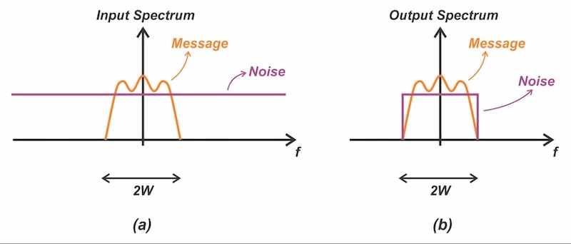

The receiver consists of an ideal low‑pass filter with bandwidth W, equal to the message bandwidth, to minimize out‑of‑band noise. Figure 10 illustrates the function of the low‑pass filter by showing the signal and noise spectra at the receiver's input and output.
Figure 10: Signal and noise spectra at the input (a) and output (b) of
the low‑pass filter.
Figure 10. Signal and noise spectra at the input (a) and output (b) of the low‑pass filter.
If the noise has a double-sided PSD of N0/2, then the noise power at the output of the receiver is N0W. If we denote the received power by Ps,in, the SNR at the output of the baseband system is:
$$SNR_{Baseband} = \frac{P_{s,in}}{N_O W}$$
Equation 8
By establishing the baseband SNR, we create a meaningful standard for comparing the SNR performance of various demodulation systems.
