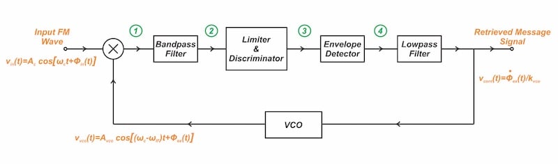

Shown in Figure 1 is the basic block diagram of the FMFB demodulator.
Figure 1. Functional block diagram of the FMFB demodulator.

The mathematical analysis provided in the previous article shows that the FMFB demodulator output is given by:
$$v_{cont}(t) = \frac{\alpha}{1 + \alpha \times k_{vco}} \times \frac{d}{dt}\phi_{in}(t)$$
Equation 2
where:
⍺ is the gain factor of the conventional demodulator incorporated in the forward path
kvco is the VCO gain factor measured in radians per second per volt (rad/sV).
Since ϕin(t) represents the phase of the input FM wave, it’s proportional to the integral of the message signal. Therefore, we observe that the VCO control voltage produces the output of the conventional demodulator—⍺ times the derivative of ϕin(t)—but attenuated by the factor 1 +⍺kvco.
Another key effect of the feedback configuration is a reduction in the deviation ratio, specifically by a factor of 1+⍺kvco. As a result, the required bandwidth of the IF bandpass filter in the FMFB demodulator is reduced by a factor of 1+⍺kvco compared to a non-feedback FM demodulator. This bandwidth reduction lowers system noise and improves the FM detection threshold.

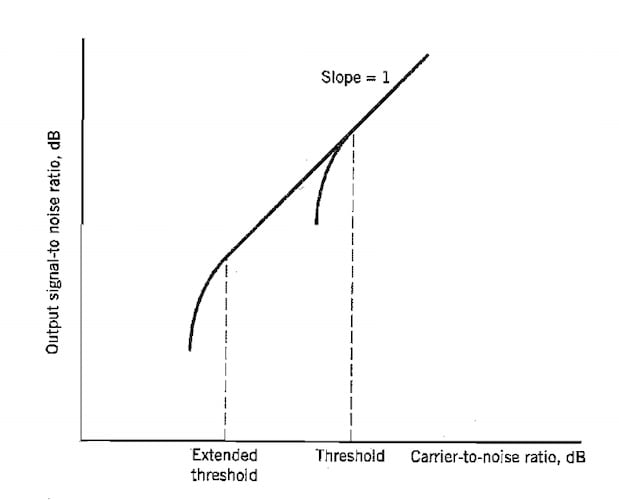

SNR Performance of FMFB at High Carrier-to-Noise Ratios
We understand that the FMFB demodulator reduces the noise threshold, but how does the feedback mechanism influence the output SNR under high CNR conditions? Before presenting the analysis, we’d like to share its concluding results to provide insight into what we’re discussing and what you can expect. Figure 2 compares the output SNR of the FMFB demodulator with that of a non-feedback FM demodulator.
Figure 2. The FMFB demodulator reduces the threshold but it doesn’t
affect the SNR at high CNR values. Image used courtesy of Simon Haykin.
Figure 2. The FMFB demodulator reduces the threshold, but it doesn’t affect the SNR at high CNR values. Image used courtesy of Simon Haykin.
We observe that although the FMFB demodulator decreases the threshold, it achieves the same SNR as the conventional demodulator when the input CNR is high. This may seem counterintuitive initially, as you might anticipate a higher SNR resulting from the noise bandwidth reduction achieved by the narrowband IF bandpass filter.
For instance, the bandpass filter in the FMFB demodulator may have a bandwidth that is just one-fifth of that in a conventional demodulator. This narrower bandwidth effectively reduces the noise entering the frequency discriminator, which suggests an expected improvement in SNR. To clarify this confusion, we’ll compute the output SNR of the FMFB circuit to better understand its noise characteristics.

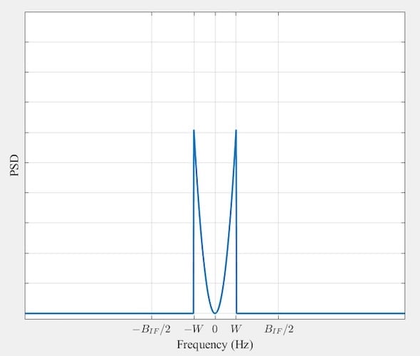

Note that the bandwidth of the quadrature noise component nQ,2(t) is determined by the IF bandpass filter. As outlined in Equation 16 and illustrated in Figure 4 below, the power spectral density of the output noise exhibits a parabolic shape due to the differentiating nature of the FM discriminator.
Figure 4. The power spectral density of noise at the output of the
lowpass filter.
Figure 4. The power spectral density of noise at the output of the lowpass filter.
If the message bandwidth is W hertz, we usually use a lowpass filter with bandwidth W at the discriminator output to minimize the noise. Therefore, the power spectral density of the output noise spans from -W to W hertz, as illustrated in the figure above. The average output noise power is obtained by taking the integral of the output power spectral density (Equation 13) over -2π×W to +2π×W:
$$P_{n,out} = \frac{1}{2\pi}\int_{-2\pi W}^{+2\pi W}\Big(\frac{\omega}{A_c(1+k_{vco})}\Big)^2 \times N_0\,d\omega = \frac{1}{(1+k_{vco})^2} \times \frac{8\pi^2 \times N_0 W^3}{3A_c^2}$$
Equation 17
