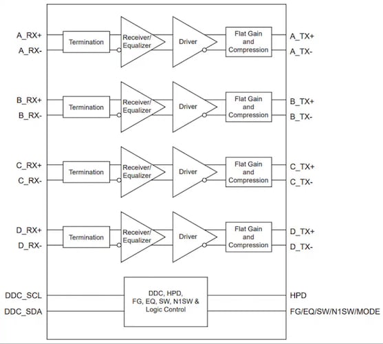

Block diagram of the hybrid redriver
Block diagram of the hybrid redriver.
The PI3HDX12311 includes a linear mode of operation, enabling data rates of up to 48 Gbps (12 Gbps per channel) and 8K DTV video resolution. The PI3HDX6311 supports flexible signal integrity, with an integrated equalization circuit, linear amplifier, and buffer circuit.
The devices can bolster transmission over increasingly longer cables using their equalization technology, which can reportedly recover weak TMDS signals and minimize jitter while maintaining image quality and reliability.
