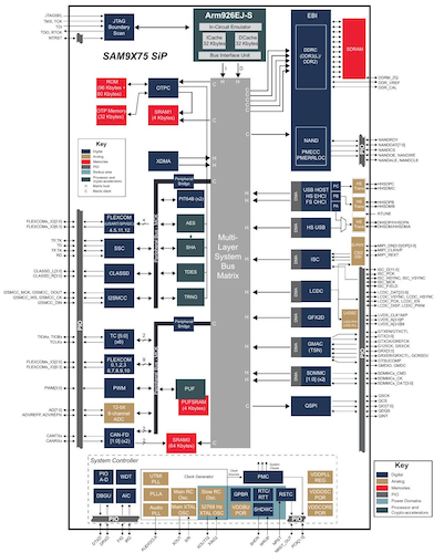

The SAM9X75D5M comes with a robust human-machine interface (HMI) feature set, including a built-in 24-bit LCD controller for displays up to 1,024 x 768 resolution. The MPU has a flexible display connection set including mobile industry processor interface (MIPI DSI), low-voltage differential signaling (LVDS), and 24-bit RGB display interfaces. Connectivity is provided by 10/100/1G Ethernet ports, SPI, high-speed USB, CAN, capacitive and resistive touch interfaces, and up to 13 flexible serial communication controllers (FLEXCOMs).
SAM9X75D5M block diagram
SAM9X75D5M block diagram. (See page 10 of the datasheet for an enlarged image)
