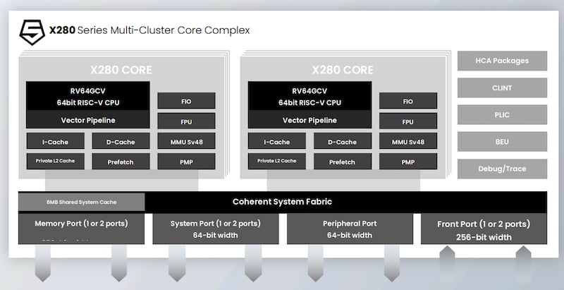

Central to the PIC64HX1000 series is the SiFive Intelligence X280 processor, a 64-bit RISC-V vector processor optimized for AI and ML workloads. This processor features a scalable multi-core and multi-cluster design with up to eight cores. Architecturally, the design integrates an eight-stage dual-issue scalar pipeline with a decoupled vector ALU pipeline. Its RISC-V, 512-bit vector length (VLEN) vector supports dynamic variable vector length operations, while the 256-bit-wide vector ALU and load/store architecture enable efficient data processing. The system’s architecture also includes a shared memory subsystem with a scalable L3 coherent cache of up to 8 MB.
The X280 series multi-cluster core complex
The X280 series multi-cluster core complex. Image used courtesy of SiFive
Microchip enhanced the X280's AI/ML performance using SiFive's Intelligence Extensions, which enable the processor to achieve up to 2.25 TFLOPs (bfloat16 MatMul) or 4.6 TOPS (INT8 MatMul). These custom extensions are tightly integrated with the RISC-V vector extension to accelerate machine learning inference. The vector pipeline supports data types like FP64, FP32, and INT8, making it versatile for various workloads. Additionally, the X280 supports vector length multipliers (LMUL) up to 8x, allowing vector operations with lengths up to 4096 bits.
For flexibility, the X280 offers multiple data ports, including 256-bit memory ports and 64-bit system ports. A decoupled scalar and vector pipeline offers parallel execution, and the design supports virtual memory with up to 48-bit addressing.
