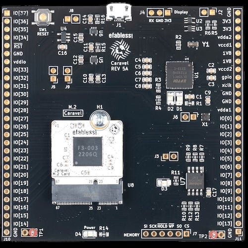

Last week, Efabless released its ChipIgnite ML custom system-on-chip (SoC) development platform at Embedded World North America 2024. The platform targets custom chip development for remote sensor applications that require machine learning (ML) AI functionality.
Efabless Chipignite ML development board
Efabless ChipIgnite ML development board. Image used courtesy of Efabless
The ChipIgnite ML platform allows edge and Internet of Things (IoT) developers to quickly design machine learning-capable silicon for remote sensor applications. The result is an application-specific integrated circuit (ASIC) that includes RISC-V processing cores and custom digital logic. All About Circuits previously spotlighted Efabless when Weebit Nano made its Resistive RAM (ReRAM) memory technology IP available through the ChipIgnite platform. At Emebdded World North America last week, All About Circuits spoke to Efabless exes Mohamed Kassem, Co-founder and CTO, Jeff DiCorpo, Senior V.P and General Manager.

“ChipIgnite ML takes the same approach as our previous SoC with a prebuilt SoC framework or chip that the customer uses as a template to customize for their part,” says DiCorpo. ”But ChipIgnite ML is a new version that is specifically optimized for this ML problem. It’s designed for building an application that has remote sensing that runs off the battery out of an edge application."
“It's bringing the power consumption from essentially milliwatts down to microwatts.”

The Efabless platform promotes custom chips optimized for IoT and remote sensing applications. These fully customizable chips integrate analog interfaces, hardware ML acceleration, and open-source MCU IP. The platform includes an automated design flow, allowing engineers without extensive chip-design experience to turn out highly optimized ML-capable custom ASICs.
Core features of the platform include:
  • 32-bit RISC-V core
  • Hard silicon IP for common ML functionality
  • Modular design flow for faster time to market
  • Clock-gated logic and low-power states to reduce power consumption
  • Customizable analog interfaces, including programmable op-amps, ADSs, DACs
  • Multi-year operability on a single coin cell battery
  • Support for devices small enough to fit into a key fob-sized package

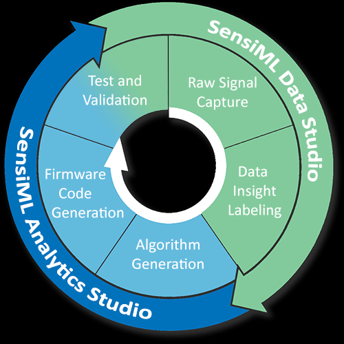

Efabless has partnered with SensiML, a sensor ML algorithm provider, to add machine learning capabilities to customer SoC designs. SensiML develops machine-learning algorithm packs for IoT devices and applications, such as acoustic event detection, gesture recognition, anomaly detection, and more.
SensiML automated workflow
SensiML automated workflow. Image used courtesy of SensiML
By focusing on ML techniques, SensiML can deliver highly optimized ML code for a wide variety of IoT sensory applications. Its ML toolkit operates with a highly automated software development workflow to reduce development and test time.
