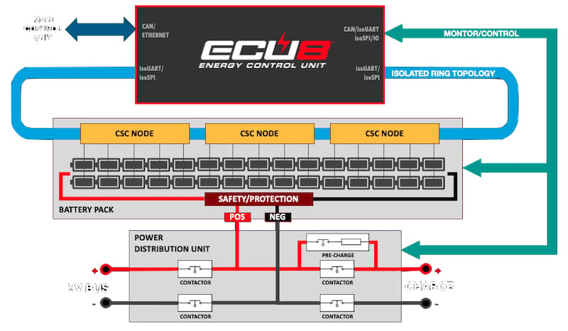

Neutron Controls says its new BMS solution, the ECU8 platform, can monitor up to 12 lithium-ion battery cells individually per module. The system can be scaled to support up to 1,000 V batteries by combining up to 20 modules. For flexible integration, the device offers a range of communication interfaces, including iso-UART and iso-SPI, dual Ethernet ports, triple CAN-FD ports, and high-side and low-side drivers for external contactors.

The system implants low-level drivers for the various components and MCUs within the system. The goal, according to the companies, is to provide a BMS solution that requires minimal development time while still reaching ASIL-D ISO26262 compliance. The system achieves this by providing designers with a pre-made solution that can effectively monitor the state of charge and state of health in a battery pack.

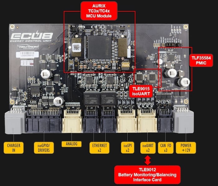

At the heart of the ECU8 platform are two Infineon MCUs: the AURIX TC3xx and TC4xx.
According to Infineon, the AURIX family of MCUs is particularly well-suited for BMS applications thanks to a combination of scalability, functional safety, and low-power operation. Additionally, the family boasts zero downtime due to its software-over-the-air update concept, meaning that systems can be upgraded without needing to shut off the BMS entirely in the interim.
The TC3xx family is engineered for a broad spectrum of automotive and industrial applications. With up to six TriCore cores running at 300 MHz and delivering 4000 DMIPS, this MCU family offers robust computational power. It also features up to 16 MB of flash memory and up to 6.9 MB of SRAM, providing ample storage for complex algorithms and data sets. Connectivity options include 1 Gbit Ethernet and 12 CAN FD, making it useful for real-time data communication in automotive systems.

The TC4xx series, on the other hand, builds upon the foundational strengths of the TC3xx. It introduces Neutron Controls' next-generation TriCore 1.8 architecture and a scalable AURIX accelerator suite, including a new parallel processing unit, data routing engine, radar accelerator, and security accelerators. These enhancements significantly boost performance, making it apt for e-mobility, ADAS, and affordable AI applications. High-speed communication interfaces like 5G-bit Ethernet and PCIe, along with new automotive-specific interfaces such as CAN-XL and 10BASE T1S Ethernet, provide the throughput and flexibility needed for modern automotive E/E architectures.
