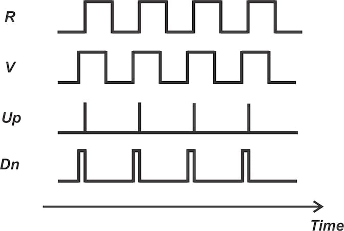

Figure 5 shows the typical waveforms when the V pulse leads the R input.
Typical waveforms when the V input is ahead of the R input.
Figure 5. Typical waveforms when the V input is ahead of the R input.
An active Up output indicates to the PLL that the VCO is lagging behind the input signal and needs to boost its frequency. This is what we see in Figure 4. The active Dn output shown in Figure 5 indicates the opposite, directing the loop to lower the VCO frequency. In this way, the active Up or Dn outputs provide information about the direction of phase error.
The width of the pulses at the active output tells us the magnitude of the phase error. When R and V pulses are in perfect phase alignment, both flip-flops will go HIGH simultaneously and reset at the same time. This creates the narrow pulses shown in Figure 6.

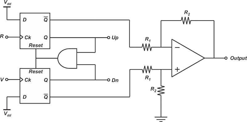

With the PFD, the final output is obtained by subtracting the Dn output from the Up output. Figure 7 shows a configuration that generates the final output using an op amp subtractor.
A PFD incorporating an op amp circuit to generate the final output.
Figure 7. A PFD incorporating an op amp circuit to generate the final output.
Since the final output is derived from the difference between the Up and Dn outputs, the narrow pulses created when the inputs are in phase (Figure 6) would ideally have no impact on circuit performance. In practice, however, these narrow pulses contribute to increased ripple on the VCO control voltage.
