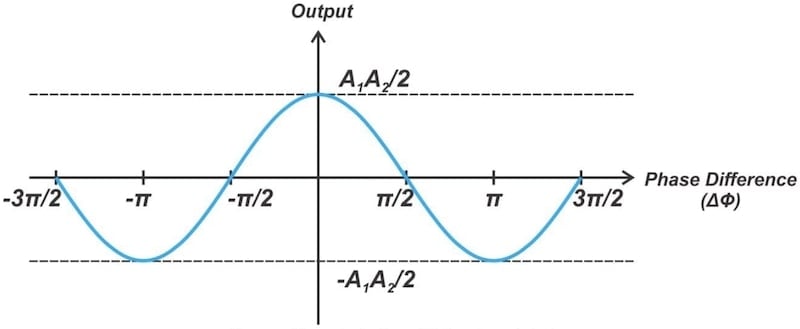

The phase detector output varies sinusoidally with the phase difference, as shown in Figure 3.
The output of a multiplier phase detector.
Figure 3. The output of a multiplier phase detector.
Assuming that the loop gain is high, the PLL locks when the phase detector output is zero. Thus, with a multiplier phase detector, the loop locks when the phase difference between the PLL input and the VCO output is 90 degrees. For this reason, a multiplier phase detector is often called a quadrature phase detector.
By differentiating Equation 4 with respect to the phase difference (Δϕ), we can determine the phase detector gain:
$$k_d ~=~ \frac{d}{d \phi}v_{out} ~=~- \frac{1}{2} A_1 A_2 \ \sin ( \Delta \phi)$$
Equation 5.
Note that the phase detector gain is a function of the phase difference. At Δϕ = 0, the gain is zero; when the loop locks at Δϕ = 90 degrees, the phase detector gain reaches its maximum value of:
$$k_d \Big \vert_{\Delta \phi = \pi/2} ~=~- \frac{1}{2} A_1 A_2$$
Equation 6.
Within any 2π interval, there are two distinct phase angles that result in a zero output from the phase detector. For instance, in the interval from –π to π, the output is zero at both –π/2 and π/2. The key questions are: which of these two points will the loop lock onto? Is it possible to achieve lock at both points?
To answer these, we need to understand that the gain (or slope) of the input-output characteristic is positive at one point and negative at the other. Depending on the sign of the gain of other components within the PLL feedback path, one point will result in a negative feedback system, while the other will create a positive feedback system.
The PLL will lock to the point associated with the negative feedback system. The other point is metastable. Therefore, the PLL will not lock to that point.
