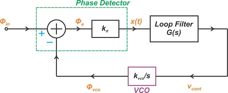

The linear model of a basic PLL is shown in Figure 1.
Linear model of a basic PLL.
Figure 1. Linear model of a basic PLL.

When we apply a frequency step, a non-zero control voltage is needed to adjust the VCO to the correct frequency. As shown in Figure 1, the control voltage is derived by multiplying the phase detector output by the DC gain of the loop filter. A non-zero control voltage therefore means the phase detector output is also non-zero.
This implies that a non-zero phase error must be present between the phase detector inputs, making it impossible for a Type-1 PLL to track a frequency step with zero phase error. To overcome this limitation, we require a loop filter with infinite DC gain to generate a non-zero control voltage from a zero phase detector output.
However, the loop filter must provide infinite gain only at DC, rather than at all frequencies. This is essential because one of the loop filter's roles is to reduce high-frequency noise and disturbances. Furthermore, increasing the loop gain at all frequencies would increase the loop bandwidth, which can result in instability.
To provide infinite DC gain, the loop filter should incorporate an integrator. This will result in a pole at the origin. The VCO also includes an integrator, bringing the total number of integrators in the loop to two. This classifies the loop as a Type-2 system.

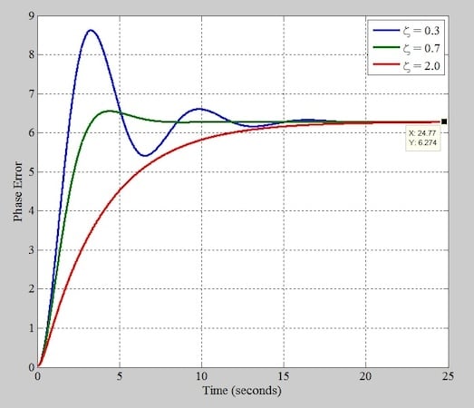

Figure 3 shows the phase error generated by Matlab for R = 1 Hz/s, ωn = 1 rad/s, and ζ = 0.3, 0.7, and 2.0.
Phase error of the Type-2 PLL in response to a frequency ramp.
Figure 3. The phase error of the Type-2 PLL in response to a frequency ramp.
Note that the final error value is 2πR/K0 = 2π = 6.28 radians. The error can be reduced by increasing the loop gain.

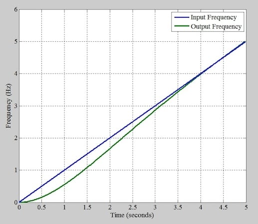

We can use the PLL transfer function given in Equation 3 to calculate the output phase (ϕvco). By taking the time derivative of ϕvco, we obtain the output frequency. To demonstrate how the output frequency follows the input frequency, Figure 4 presents the output frequency for R = 1 Hz/s, ωn = 1 rad/s, and ζ = 0.7.
The Type-2 PLL's input frequency (blue) and output frequency (green) when the input is a frequency ramp.
Figure 4. The Type-2 PLL's input frequency (blue) and output frequency (green) when the input is a frequency ramp.
