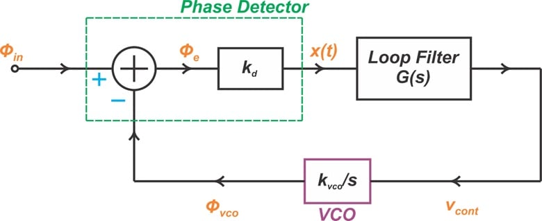

Figure 1 shows the linear model of a basic second-order PLL.
Linear model of a basic PLL.
Figure 1. Linear model of a basic PLL.

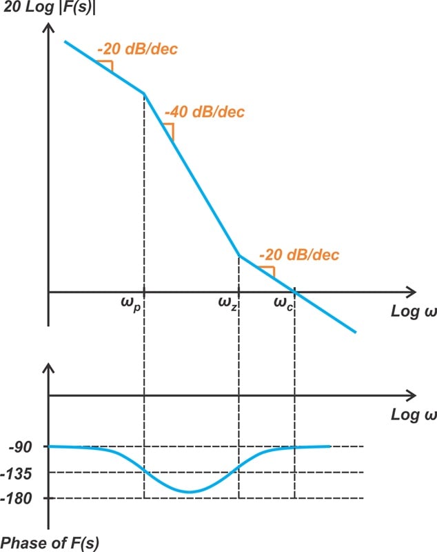

Deriving the Bode Plots
For a second-order PLL with a lag-lead filter, the open-loop transfer function is:
$$F(s) ~=~ \frac{K_0}{s} ~\times~ \frac{1+ s / \omega_z}{1~+~ s / \omega_p}$$
Equation 7.
One important scenario is when the pole frequency is less than the zero frequency (ωp < ωz) and the zero frequency is less than the gain crossover frequency (ωz < ωc). The condition ωp < ωz guarantees a lowpass magnitude response, while ωz < ωc ensures that the positive phase shift introduced by the zero enhances stability at the crossover frequency. Figure 2 shows the typical Bode diagram for ωp < ωz < ωc.
Bode plots of a PLL with a lag-lead loop filter.
Figure 2. [click to enlarge] Bode plots of a PLL with a lag-lead loop filter.
At low frequencies, the integration action of the VCO results in an asymptotic amplitude slope of –20 dB per decade and a phase angle of –90 degrees. The pole of the loop filter creates an additional breakpoint in the asymptotic gain plot. At the pole frequency, the asymptotic amplitude slope changes to –40 dB per decade and the phase angle reaches –135 degrees. Note that this phase value requires the pole and zero to be far enough apart in frequency.
At some frequency between ωp and ωz, the phase angle attains its most negative value, potentially approaching –180 degrees if the pole and zero are sufficiently separated. As we approach and exceed ωz, the zero contributes a positive phase to the transfer function, causing the overall phase to approach –90 degrees at high frequencies. The zero also introduces a breakpoint in the asymptotic gain plot, changing the slope from –40 to –20 dB per decade.

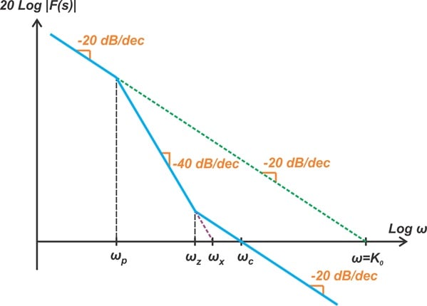

Identifying the Natural Frequency in Bode Plots
The low-frequency region of the magnitude plot with a –20 dB per decade slope corresponds to the term K0/jω from the open-loop transfer function shown in Equation 7. The slope of this region is inversely proportional to frequency. As a result, the extension of this line intersects the horizontal axis, which corresponds to a gain of unity (or 0 dB), at ω = K0. This is illustrated in Figure 3.
The extension of the first section of the plot intersects the horizontal axis at the point where the frequency equals the loop gain.
Figure 3. The extension of the first section of the plot intersects the horizontal axis at ω = K0.
Now, consider the part of the magnitude plot characterized by a –40 dB per decade slope. Extending this line will result in an intersection with the horizontal axis at a specific frequency, denoted by ωx in the above figure. Since the slope of the line going through ωx is twice that of the green line going through ω = K0, we can conclude that ωx is midway between ωp and ω = K0 on a logarithmic plot. In other words, we have:
$$\log(\omega_x) ~-~ \log(\omega_p) ~=~ \log(K_0) ~-~ \log(\omega_x)$$
Equation 8.
By applying some logarithmic manipulations, the expression above can be simplified as follows:
$$\begin{eqnarray} 2\log(\omega_x) &~=~& \log(K_0) ~+~ \log(\omega_p) \\ \omega_x^2 &~=~& K_0 \omega_p \\ \end{eqnarray}$$
Equation 9.
Comparing the final result with the definition of the natural frequency (ωn) as given in Equation 4, we observe that ωx = ωn. Thus, the extension of the line with a –40 dB per decade slope intersects the horizontal axis at ω = ωn.
Determining the Gain Crossover Frequency
Let's take another look at the open-loop Bode plot (Figure 4).
While the purple line has a slope of negative 40 dB per decade, the line going through the crossover frequency has a slope of negative 20 dB per decade.
Figure 4. While the purple line has a slope of –40 dB per decade, the line going through ωc has a slope of –20 dB per decade.
The key observation here is that the purple line going through ωn has a slope of –40 dB per decade, whereas the line going through ωc has a slope of –20 dB per decade. By applying a similar logic to that discussed in the previous section, we can conclude that ωn is also positioned midway between ωz and ωc on a logarithmic plot. This results in the following expression:

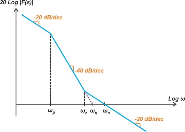

Estimating the Damping Factor
Based on the Bode plot presented in Figure 4, we may infer that ωn is much greater than ωp. Under this assumption, we can proceed to simplify the damping factor defined in Equation 6 as follows:
$$\zeta ~=~ \frac{1}{2} (\frac{\omega_p}{\omega_n} ~+~ \frac{\omega_n}{\omega_z}) ~\approx~ \frac{\omega_n}{2 \omega_z}$$
Equation 12.
Considering the logarithmic nature of the Bode diagram's x-axis, the above relationship can be transformed into logarithmic terms as follows:
$$\log(\omega_n) ~\approx~ \log(\omega_z) ~+~ \log(2 \zeta)$$
Equation 13.

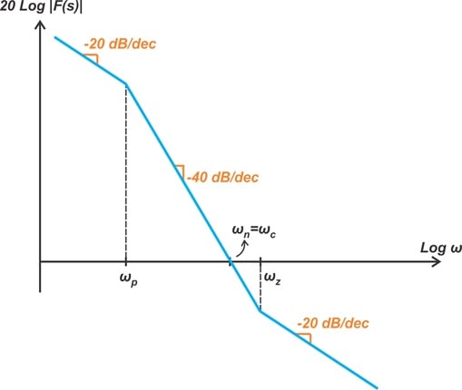

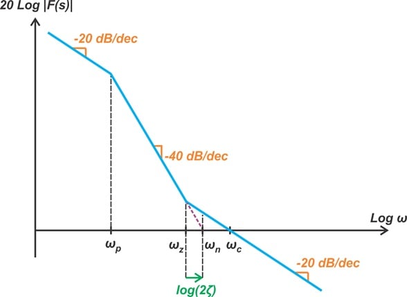

In other words, if we add log(2ζ) to the zero frequency, we obtain the loop natural frequency on the Bode plot. Figure 5 helps us to visualize this relationship.
Illustrating the relationship between the zero frequency, the natural frequency, and the damping factor.
Figure 5. Illustrating the relationship between ωz, ωn, and ζ.

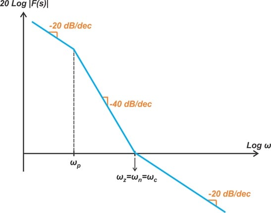

For example, if we choose ζ = 0.5, we obtain log(2ζ) = 0. We therefore have ωz ≈ ωn. In this scenario, the breakpoint introduced by the zero occurs at ωn, which is also identified as the gain crossover frequency. This is illustrated in Figure 6.
The typical Bode plot when the damping factor equals 0.5.
Figure 6. The typical Bode diagram when ζ = 0.5.
When ζ exceeds 0.5, the term log(2ζ) becomes positive, placing ωn and ωc to the right of the zero, as illustrated in Figure 5. As the zero appears before the crossover frequency, we can take advantage of its stabilizing effect. We saw that for ζ = 0.5, ωz coincides with ωn = ωc (Figure 6 above).

As previously noted, the pole-zero configuration of practical significance is typically the one where ζ is greater than 0.5. The Bode diagram presented in Figure 5 therefore holds greater importance for our analysis. Before we move on, it's also worth mentioning that by combining Equations 10 and 12, we can express the unity-gain frequency as:
$$\omega_c ~=~ 2 \zeta \omega_n$$
Equation 14.

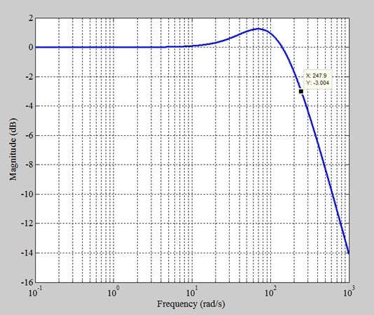

Having determined ωp and ωz, we can utilize Matlab to generate the magnitude response of the closed-loop system without any approximations, as provided in Equation 8. The resulting Bode plot is shown in Figure 8.
Magnitude response of the closed-loop system.
Figure 8. The magnitude response of the closed-loop system.
The 3 dB bandwidth is approximately 248 rad/s, which is close to the target value of 200 rad/s. This indicates that our simplified analysis, which incorporates various approximations, is accurate enough to be used as a rapid analysis method. To determine the phase margin, we use Matlab to calculate the magnitude and phase of the open-loop transfer function (Equation 7). The result is shown in Figure 9.
