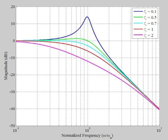

Figure 2 plots |H(jω)| against the normalized frequency (ω/ωn) for various values of the damping factor (ζ).
Magnitude response of the second-order PLL for various values of the damping factor.
Figure 2. Magnitude response of the second-order PLL for various values of the damping factor.
When analyzing the frequency response of a second-order system, the damping factor ζ = 0.707 represents a crucial transition in the system's behavior. At ζ = 0.707, we achieve a maximally flat frequency response. In this case, the response is smooth and flat over the widest possible bandwidth before it begins to roll off.
For ζ < 0.707, the gain exhibits peaking in the frequency domain. When ζ is greater than 0.707, on the other hand, there is no gain peaking and the bandwidth of the system is narrower compared to systems with lower damping factors.

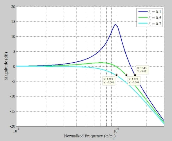

Closed-Loop Bandwidth
The closed-loop 3 dB bandwidth can be determined by setting the magnitude response equal to \(\frac{\sqrt{2}}{2}\) and determining the corresponding frequency. It can be shown that for ζ < 1, the 3 dB bandwidth is given by:
$$\omega_b ~=~ \omega_n \sqrt{1~-~2 \zeta^2 ~+~ \sqrt{2~-~ 4 \zeta ^2 ~+~ 4 \zeta^4}}$$
Equation 9.
For instance, with ζ = 0.1, the bandwidth works out to ωb = 1.54 × ωn. Figure 3 marks the 3 dB bandwidths for three different values of the damping factor: ζ = 0.1, 0.5, and 0.7.
The closed-loop bandwidth for selected values of the damping factor.
Figure 3. The closed-loop bandwidth for selected values of ζ.
Of particular interest is the case where ζ = 0.7, resulting in ωb = ωn.

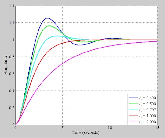

Step Response
Figure 4 shows the typical step response of the second-order system described by Equation 3 for ωn = 1 rad/s and selected values of ζ.
The step response for a natural frequency of 1 rad/s and selected values of the damping factor.
Figure 4. The step response for ωn = 1 rad/s and several values of ζ.
When examining the response in the time domain, ζ = 1 marks the point where the system's behavior transitions. For ζ < 1, we have an underdamped system, resulting in a damped sinusoidal oscillation in the output. At ζ = 1, the system is critically damped, with the transfer function having two identical poles.
For ζ > 1, the system has two distinct negative real poles. In this case, the time-domain response includes two decaying exponential terms. When ζ is considerably greater than 1, one of the two decaying exponentials reduces much more quickly than the other. Consequently, the faster-decaying exponential term (which has a smaller time constant) may be disregarded, allowing the response of the second-order system to be approximated by a simple first-order system.
Figure 4 demonstrates that an overdamped system has the slowest response. Although the figure depicts only the step response, this is true for any input. Moreover, of the systems that respond without oscillation, a critically damped system has the fastest response. A slightly underdamped system, with ζ around 0.7, gets close to the final value more rapidly than a critically damped or overdamped system.
Before we move on, note that second-order systems with closed-loop transfer functions different from Equation 3 may have step responses that differ greatly from those in Figure 4.

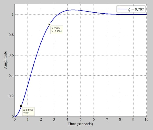

By way of example, consider ζ = 0.7. From Equation 9, we know that ωb = ωn. If we assume that ωn = 1 rad/s, then the rise time is tr = 2.2 s. Figure 5 shows the step response for ζ = 0.7 and ωn = 1 rad/s, confirming our rise time calculation.
The step response rise time for a natural frequency of 1 rad/s and a damping factor of 0.7.
Figure 5. The step response rise time for ωn = 1 rad/s and ζ = 0.7.
Using the data points provided in the figure, the rise time is 2.654 – 0.5056 = 2.15 seconds, which is reasonably close to the calculated value.
As an aside, Equation 10 is an approximation for second-order systems like this one. However, it is exact for first-order systems.
