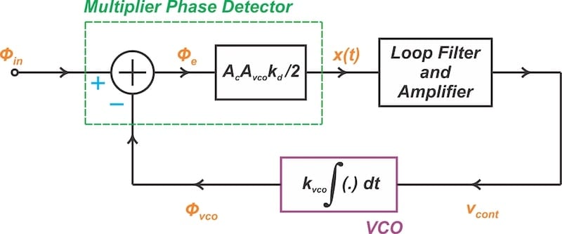

This allows us to model the PLL with an LTI system when it's locked. The linearized model of the analog PLL is shown in Figure 3.
Linear model of a PLL with a multiplier phase detector.
Figure 3. Linear model of a PLL with a multiplier phase detector.
The VCO's transfer function in the frequency domain is:
$$\frac{\phi_{vco}}{v_{cont}}(s) ~=~ \frac{k_{vco}}{s}$$
Equation 3.

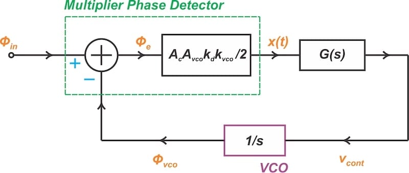

where s = jω is the complex frequency (Laplace) variable. Therefore, the frequency-domain model of the PLL is as illustrated in Figure 4.
Linear model of the PLL in the frequency domain.
Figure 4. Linear model of the PLL in the frequency domain.
When analyzing a PLL's linear model, it's useful to look at two different transfer functions. The first transfer function, H(s), describes the relationship between ϕin to ϕvco. Using some algebra, H(s) is obtained as:
$$H(s) ~=~ \frac{\phi_{vco}}{\phi_{in}} (s) ~=~ \frac{K_0 G(s)}{s~+~K_0 G(s)}$$
Equation 4.
where G(s) is the loop filter's transfer function and K0 is the total loop gain. Note that in the above figures, K0 is expressed as 0.5AcAvcokdkvco.
The second transfer function, He(s), gives the relationship between the input phase (ϕin) and the phase error (ϕe):
$$H_e(s)~=~\frac{\phi_e}{\phi_{in}} (s) ~=~ \frac{\phi_{in}~-~\phi_{vco}}{\phi_{in}}~=~ 1~-~H(s) ~=~ \frac{s}{s~+~K_0 G(s)}$$
Equation 5.
By examining H(s) and He(s), we can determine how the PLL tracks different types of inputs and identify the feedback loop error as it attempts to do so.

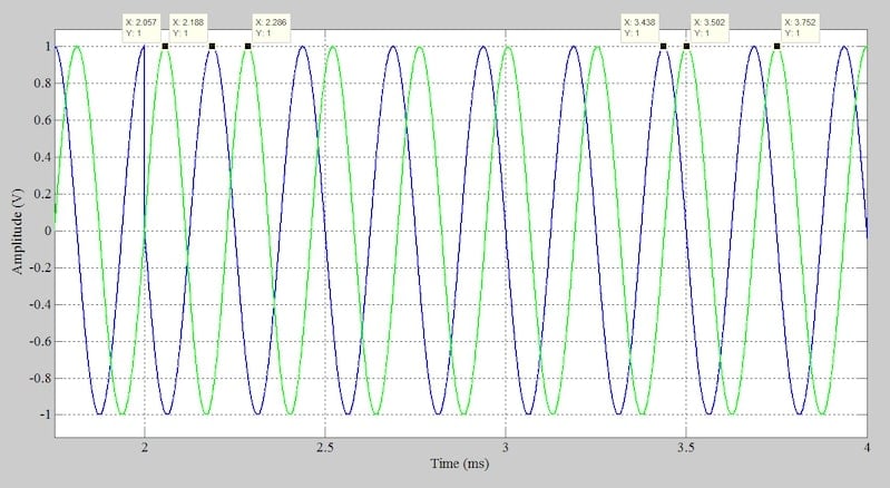

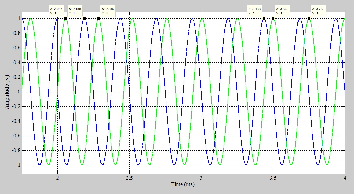

The PLL input and VCO output signals are shown in Figure 8, along with some data points to help us verify the loop behavior. Note that the points may be hard to read in the image below. Clicking on the figure will open a larger, more legible version.
Comparing the waveforms of the PLL input (blue) and the VCO output (green).
Figure 8. [click to enlarge] Comparing the waveforms of the PLL input (blue) and the VCO output (green).
From the data points associated with the VCO's peaks at times t = 2.057 ms and 2.286 ms, we see that the VCO frequency is nearly 4.37 kHz after the phase step. On the other hand, the data points associated with times t = 3.502 ms and 3.752 ms show that the VCO frequency reduces to 4 kHz just before t = 4 ms. As shown in Figure 7, the control voltage drops back to nearly zero at t = 4 ms.
Additionally, note how the phase difference between the input signal and VCO output changes over time. Before applying the phase step at t = 2 ms, there's a phase difference of 90 degrees between the two waveforms. The peak of the blue waveform occurs when the rising part of the green waveform crosses zero. This 90-degree phase difference results from using a multiplier phase detector.
Directly after the phase step, the phase difference exceeds 90 degrees. Using the data points provided in Figure 8, the time difference between the peaks of the two waveforms is 2.188 – 2.057 = 0.131 ms. If we assume that the two signals are at 4 kHz, which corresponds to a period of 0.25 ms, a time difference of 0.131 ms corresponds to a phase difference of about 188.6 degrees.
However, the loop then tries to follow the input phase, bringing the phase difference back to 90 degrees at about t = 4 ms. This confirms that the first-order PLL can track a phase step with zero steady-state error.
