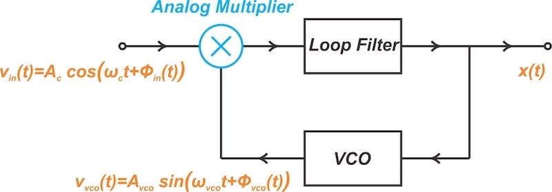

The input FM wave and VCO output signal equations for a simple PLL arrangement are shown in Figure 5.
The VCO output exhibits a 90 degree phase shift relative to the incoming FM wave.
Figure 5. The VCO output exhibits a 90-degree phase shift relative to the incoming FM wave.
In the locked condition, the VCO oscillates precisely at the unmodulated carrier frequency (ωc = ωvco) and the loop sustains a 90-degree phase difference between the input FM wave and the VCO output. Hence, with a cosine input waveform, the VCO output is considered to be a sine wave. Under lock conditions, the feedback mechanism results in:

A similar equation relates the VCO's angle, ϕvco(t), to its control voltage, x(t):
$$\phi_{vco} (t) ~=~ 2 \pi k_{vco}\int_{0}^{t} x(\alpha) \ d \alpha$$
Equation 5.
where kvco is the frequency sensitivity of the VCO measured in Hz/V.
Substituting Equations 4 and 5 into Equation 3 yields:
$$k_{vco} x(t) ~\approx~ k_{f} m(t) \quad \Rightarrow \quad x(t) ~\approx~ \frac{k_{f}}{k_{vco}}m(t)$$
Equation 6.
It is evident that the VCO's control voltage reproduces the message signal.

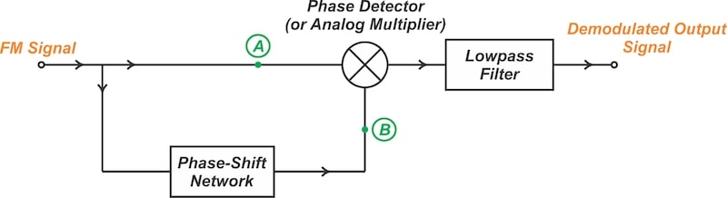

In a previous article, we learned about FM demodulation using a quadrature detector (Figure 6). In a quadrature detector, both the input FM signal and its phase-shifted signal are directed to a phase detector. The output is subsequently processed by a lowpass filter.
Quadrature detector block diagram.
Figure 6. Block diagram of a quadrature detector.
It's noteworthy that the quadrature detector and the PLL exhibit certain similarities in their operation. Both the quadrature detector and the PLL employ a phase detector followed by a lowpass filter.
In a quadrature detector, the phase-shift network produces a nominal 90-degree phase shift at the unmodulated carrier frequency. In the PLL, the feedback arrangement maintains a 90-degree phase difference between the input FM wave and the VCO output. In both the quadrature detector and the PLL, the phase detectors operate on identical signals, comparing the input FM signal to its phase-shifted version.
