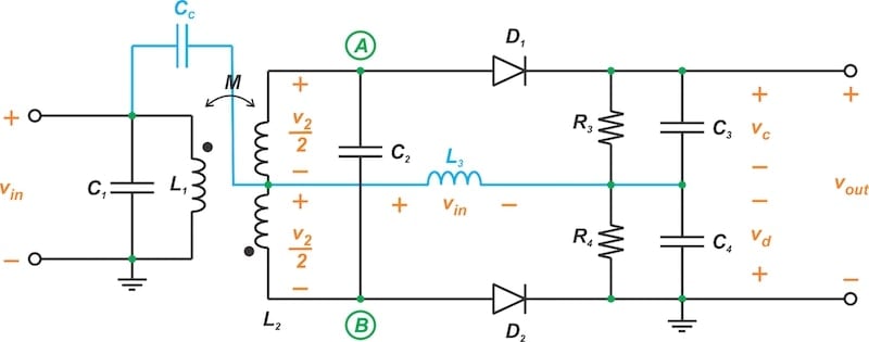

The Foster-Seeley discriminator.
Figure 1. The Foster-Seeley discriminator.

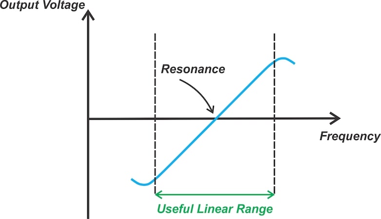

For frequencies above resonance, the output voltage of this circuit is positive. For frequencies below resonance, the output voltage is negative. The frequency response of the Foster-Seeley discriminator can be seen in Figure 2.
Typical frequency response of the Foster-Seeley discriminator.
Figure 2. Typical frequency response of the Foster-Seeley discriminator.
How the Foster-Seeley discriminator achieves this response might not be immediately clear from its schematic. To clarify, we'll examine the operation of the circuit's key components. We'll then build on what we've learned to explain the overall circuit's functionality.

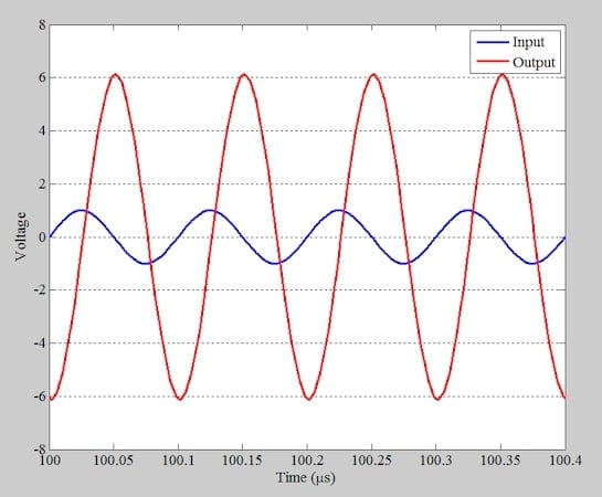

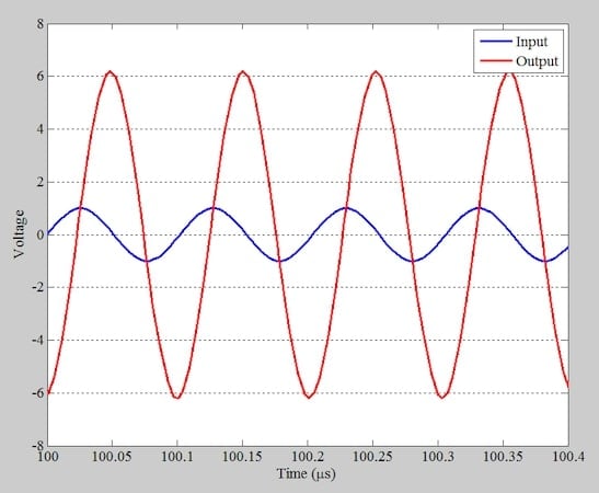

We now apply a 10 MHz sinusoidal input and take the voltage across the capacitor as the output. Figure 4 shows the result from an LTspice simulation.
Input voltage (blue) and output voltage (red) for a 10 MHz signal.
Figure 4. Input voltage (blue) and output voltage (red) for a 10 MHz signal.
The input and output waveforms' relative positions along the time axis clearly indicate that the output is –90 degrees out of phase with the input. This means the circuit introduces a –90 degree phase shift at the resonant frequency. While we could certainly confirm this mathematically, in this article we'll use simulation results to gain perspective without delving into the mathematical proof.

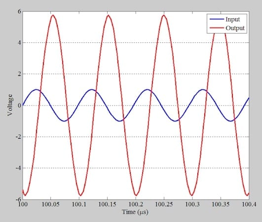

If we increase the input frequency to 10.2 MHz, we obtain the waveforms in Figure 5.
Input and output voltage for a 10.2 MHz signal.
Figure 5. Input voltage (blue) and output voltage (red) for a 10.2 MHz signal.
For frequencies above the resonant frequency, the absolute value of the phase shift is greater than –90 degrees. Figure 6 displays the waveforms at 9.8 MHz, which is slightly below the resonant frequency.

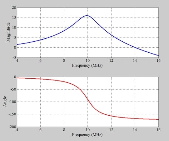

Below the resonant frequency, the absolute value of the phase shift is smaller than –90 degrees. The same results can be obtained by using an AC analysis, the results of which are shown in Figure 7.
The RL circuit's frequency response, separated into magnitude (top plot) and phase (bottom plot).
Figure 7. The RLC circuit's frequency response: magnitude (top) and phase (bottom).
Within a narrow frequency band around the resonant frequency, the magnitude response remains nearly constant while the phase shift varies approximately linearly with frequency. This frequency-sensitive phase shift is employed in the Foster-Seeley discriminator to demodulate FM waves.

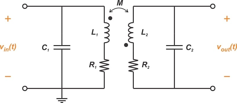

The Role of the Coupled Inductors
As shown in Figure 8, the Foster-Seeley discriminator employs coupled inductors to apply the input to the series RLC circuit. The mutually-coupled, double-tuned circuit has high primary and secondary Q-factors and a low mutual inductance.
The coupled inductors used in the Foster-Seeley discriminator.
Figure 8. The coupled inductors used in the Seeley-Foster discriminator.
Before we move on, note that capacitors are used across both primary and secondary windings. This suggests that the coupling between the inductors is less than unity. If it were unity, a single capacitor on either side would be adequate.
For simplicity, we assume that R1, the series resistance of L1, is negligible. Additionally, we assume that the impedance coupled into the primary circuit is insignificant relative to the primary self-impedance. Consequently, the primary current can be calculated as:
$$I_{1} ~=~ \frac{V_{in}}{j \omega L_1}$$
Equation 2.
The primary current induces a voltage in the secondary that can be modeled by a voltage source in series with L2, leading to a secondary circuit model similar to that we studied in the previous section. The induced voltage depends on the mutual inductance (M) between the two inductors. Assuming that the winding directions are chosen to produce a negative mutual inductance, the induced voltage is obtained as:
$$V_{s} ~=~ j \omega M ~\times~ I_{1} ~=~ -j \omega M ~\times~ \frac{V_{in}}{j \omega L_1} ~=~ \frac{M}{L_1} ~\times~ V_{in}$$
Equation 3.
The voltage that appears at the secondary is already 180 degrees out of phase with respect to Vin. We also know that the series RLC circuit produces a phase shift of –90 degrees at the resonant frequency. Above the resonant frequency, this phase shift becomes more negative. Below it, the phase shift becomes less negative.

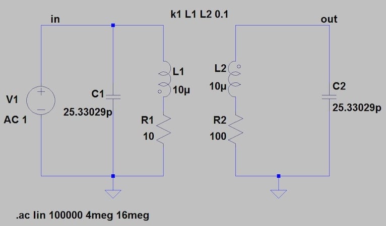

To confirm these results, we'll conduct an AC analysis on the LTspice circuit in Figure 9.
LTspice schematic for examining the Foster-Seeley discriminator's phase network.
Figure 9. LTspice schematic for examining the Foster-Seeley discriminator's phase shift network.

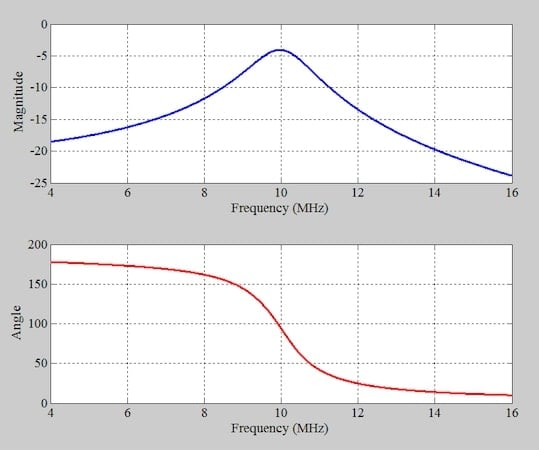

The K statement in the above diagram defines the coupling between the two inductors. As previously noted, the coupling in the Foster-Seeley discriminator is less than unity. To be consistent, we have selected a small value of 0.1. Figure 10 shows the results of the AC analysis.
The phase-shift network's frequency response: magnitude (top) and phase (bottom).
Figure 10. The phase shift network's frequency response: magnitude (top) and phase (bottom).
We can see that the phase shift is around 90 degrees at the resonant frequency (10 MHz), more than 90 degrees below the resonant frequency, and less than 90 degrees above it.

Now that we've discussed its key components, we're ready to analyze the Foster-Seeley discriminator as a whole. For convenience, Figure 11 reproduces the schematic.
Figure 11. The complete Foster-Seeley discriminator schematic.
The capacitors Cc and C4 act as short circuits at RF. The input voltage (vin) therefore appears across L3, which is chosen so that it's large enough to act as an RF choke.
The secondary winding (L2) is split into two sections. In the above figure, the voltages at nodes A and B are given by:
$$v_{A}~ =~ v_{in} ~+~ \frac{v_2}{2} \quad \text{and} \quad v_{B} ~=~ v_{in} ~-~ \frac{v_2}{2}$$
Equation 4.
where v2 is the total voltage across L2.

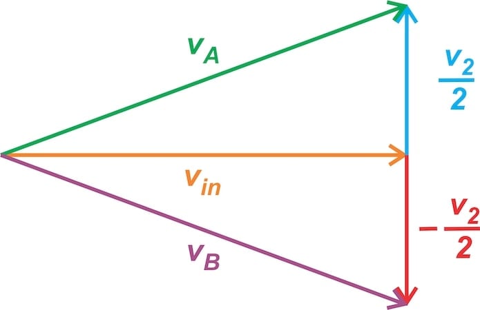

From our earlier discussion, we know the phase-frequency relationship between vin and v2. At the resonant frequency, v2 leads vin by 90 degrees, resulting in the vector diagram shown in Figure 12.
Vector representation of voltages at resonance.
Figure 12. Vector representation of voltages at resonance.
The outputs of the diode detectors (vc and vd) are proportional to the magnitudes of vA and vB. The overall output (vout) is given by:
$$v_{out} ~=~ v_c ~-~ v_d ~=~ \eta |v_A| ~-~ \eta |v_B|$$
Equation 5.
where η is the rectification efficiency.

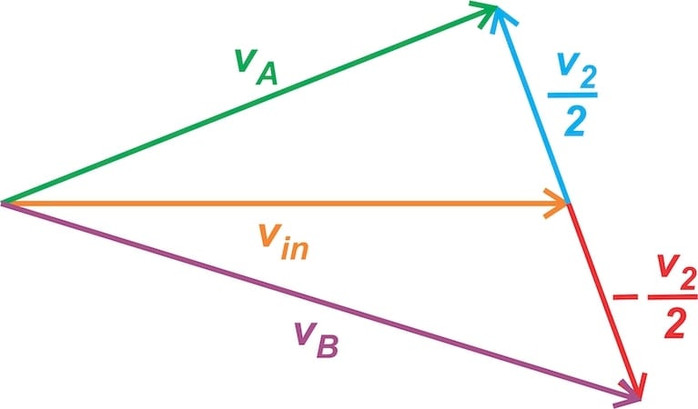

At resonance, Equation 5 results in zero due to the equal magnitudes of the vA and vB vectors. Below resonance, the voltage across the secondary leads the input by more than 90 degrees, leading to the vector diagram in Figure 13.
Vector representation of voltages below resonance.
Figure 13. Vector representation of voltages below resonance.
Since the magnitude of vA is smaller than that of vB, Equation 5 produces a negative output voltage below resonance.

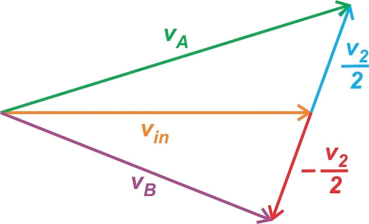

Finally, when the input frequency is above the resonant frequency, the voltage across the secondary leads the input voltage by less than 90 degrees. This produces the vector diagram in Figure 14.
Vector representation of voltages above resonance.
Figure 14. Vector representation of voltages above resonance.
In this case, the magnitude of vA is greater than that of vB, which means that a positive voltage appears at the output above the resonant frequency.
