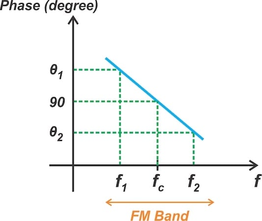

As observed, the network exhibits a nominal 90-degree phase shift at the carrier frequency (when ω = ωc). As the input frequency deviates from ωc, an additional phase shift term proportional to ω – ωc is introduced. Therefore, the typical phase response of the network around the carrier frequency is as shown in Figure 2.
The phase-shift network introduces a phase shift proportional to the input frequency.
Figure 2. The phase-shift network introduces a phase shift proportional to the input frequency.

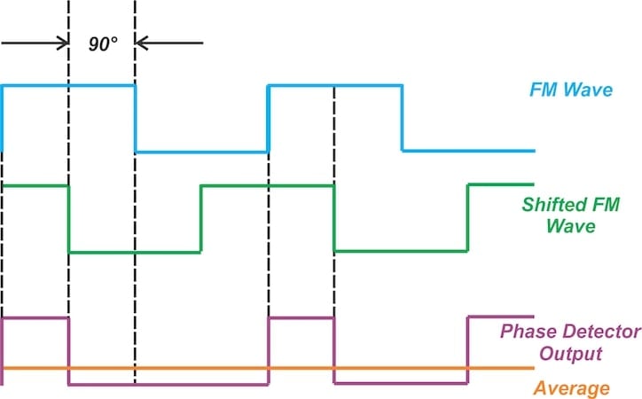

Typical Waveforms at the Carrier Frequency
First, consider the case where the instantaneous frequency (fi) equals the unmodulated carrier frequency (fc). These waveforms are shown in Figure 3.
Typical waveforms when the input frequency equals the carrier frequency.
Figure 3. Typical waveforms when the input frequency equals the carrier frequency.
When fi = fc, the phase-shifted signal leads the incoming FM wave by exactly 90 degrees. With a 90-degree phase difference, the two square waves overlap for one quarter of the period. The output of the AND gate is therefore a square wave with a duty cycle of one quarter. The average value of the output is 1/4 of the square wave's amplitude.

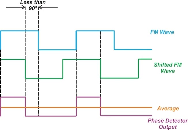

Typical Waveforms Below the Carrier Frequency
Next, let's examine the typical waveforms when the input frequency is lower than the carrier frequency. These are illustrated in Figure 4.
Typical waveforms when the input frequency is lower than the carrier frequency.
Figure 4. Typical waveforms when the input frequency is lower than fc.
In this case, the phase shift between the FM wave and its shifted version is greater than 90 degrees. As a consequence, the overlap between the two signals is less than one quarter of the period.
Averaging these narrower pulses yields a lower output voltage (less than 1/4 of the square wave's amplitude). This reflects the original lower-amplitude modulating signal.

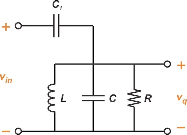

A phase-shift network can be implemented using either a bandpass filter or a delay line. Figure 7 shows a commonly used phase-shift network based on an RLC circuit.
RLC network for realizing the phase-shift network.
Figure 7. RLC network for realizing the phase-shift network.
In the above circuit, the input signal is fed through a small capacitor (C1) into a parallel tuned circuit. The resonant frequency of the tuned RLC circuit is almost equal to the carrier frequency of the incoming FM wave. At the carrier frequency (fc), the network can thus be considered as a capacitor in series with a purely resistive component (R).
Due to its capacitive nature, the current through the network leads the input voltage by 90 degrees. This current then flows through the resistor (R), generating an output voltage that leads the input FM wave by 90 degrees.
When the input frequency deviates from fc, the phase shift of the network varies in accordance with it. Determining the exact phase response of the circuit requires establishing the circuit's input-output relationship. Skipping the mathematical derivation, it can be easily shown that the circuit's transfer function is:
$$\frac{V_q}{V_{in}} ~=~ \frac{j \omega RC_1}{1 ~+~ jR \big ( \omega(C~+~C_1) ~-~ \frac{1}{\omega L}\big)}$$

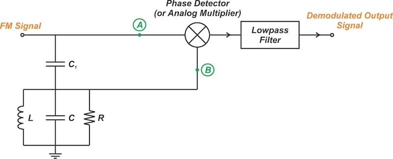

Figure 9 shows the schematic of a quadrature detector employing the RLC phase-shift network of Figure 7.
A quadrature detector with RLC phase-shift network.
Figure 9. A quadrature detector with RLC phase-shift network.
