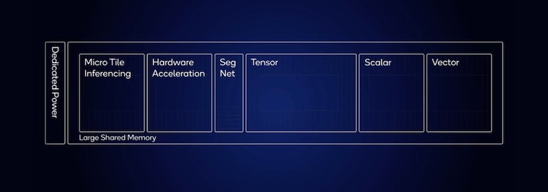

Qualcomm has fitted the MBM715 with a Hexagon processor in a fused accelerator layout that pairs scalar, tensor, and vector engines with their own power delivery—enough to host large language models and generative assistants on the device.
Hexagon NPU
Qualcomm calls the Hexagon NPU the "star of the Qualcomm AI engine."
Developers can compile and deploy models through Qualcomm AI Hub, removing the cloud round-trip for interface responsiveness and keeping prompt data local. That makes the parts suitable for smart-home hubs, in-store assistants, and edge agents that need to run multimodal models without a backhaul dependency.
