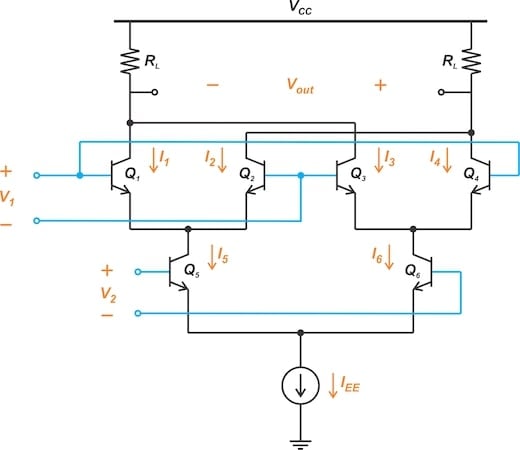

Analog multipliers are the most commonly utilized phase detectors in PLLs that operate with sine-wave inputs and sine-wave voltage-controlled oscillators (VCOs). They are often designed using a Gilbert-type architecture. Figure 1 shows the core structure of the Gilbert multiplier.
Basic Gilbert multiplier.
Figure 1. The basic Gilbert multiplier.
To understand how the Gilbert multiplier operates, you can check out my previous article. In this article, we'll explore the use of the Gilbert cell as a phase detector under three distinct conditions:

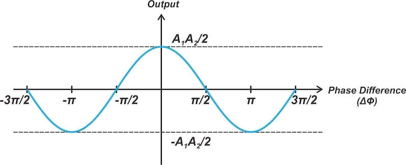

Equation 3 shows that, for a given phase difference, the output of the phase detector is a DC term. The phase detector output varies sinusoidally with Δϕ, as illustrated in Figure 2.
The phase detector's output vs. its input phase error when both inputs are small.
Figure 2. The phase detector's output vs. its input phase error when both inputs are small. The circuit acts as an analog multiplier.

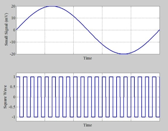

In this case, we commonly apply the small sinusoidal signal to the lower differential pair (Q5 and Q6). The square wave is applied to the cross-coupled pairs of the Gilbert cell (transistors Q1 through Q4). If the square wave amplitude is sufficiently larger than 2VT, then two of the four transistors in the cross-coupled pair alternately turn completely off and the other two conduct all the current.
By using the Gilbert cell schematic presented in Figure 1, you can easily confirm that the circuit transfers the sinusoidal input to the output with either its original or inverted polarity during the two half-cycles of the square wave. To help us visualize this, the following two figures show the typical waveforms for this scenario. Figure 3 shows the input waveforms.
Waveforms for two input signals, one sinusoidal and one a square wave, applied to the Gilbert multiplier.
Figure 3. The small sinusoid (top) and the large square wave (bottom) applied to the Gilbert cell.

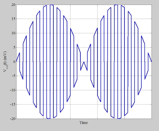

The output waveform is illustrated in Figure 4.
The output of the Gilbert multiplier.
Figure 4. The output waveform of the Gilbert cell when one of the inputs is a square waveform.
Note how the polarity of the sinusoidal wave alternates with each half-cycle of the square wave.
When you compare the input and output waveforms shown in Figures 3 and 4 with those from double-balanced AM modulators, such as the ring modulator, you'll see that both circuits generate identical waveforms. This suggests that the Gilbert cell can serve two distinct functions: as a phase detector and as an AM modulator.

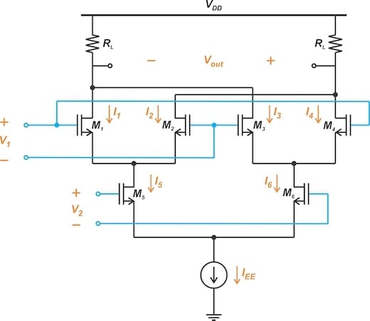

The CMOS Gilbert Cell
As we discussed in the previous article, when inputs applied to the Gilbert cell are small, the circuit leverages the exponential transfer function of bipolar transistors to perform multiplication. However, when V1 is significantly larger than 2VT, the transistors in the cross-coupled pair (Q1 through Q4) operate as switches and their specific nonlinearity characteristics are not important.
In such cases, it's possible to use MOS transistors to implement the circuit. This implementation of the Gilbert cell is shown in Figure 5.

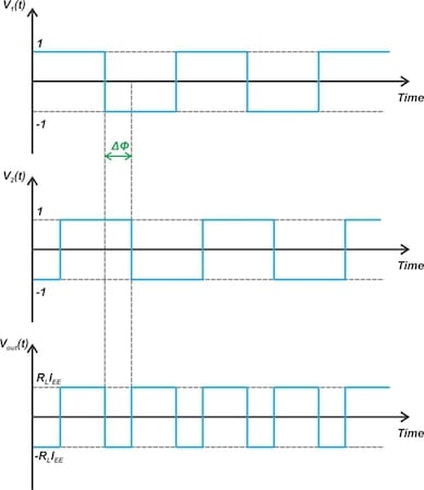

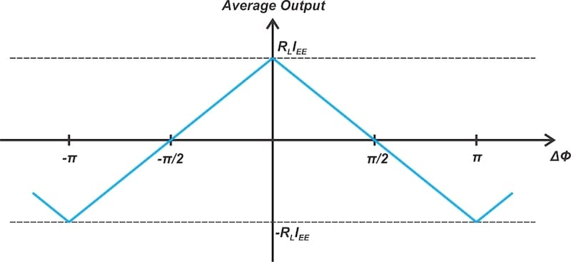

Phase Detection With the Gilbert Cell: Both Inputs at High Levels
The last scenario we'll examine is when both inputs are large. This results in all transistors functioning as switches. Figure 6 illustrates the typical input and output waveforms for this scenario, denoting the phase difference between the inputs as Δϕ.
Typical input and output waveforms when both inputs are large.
Figure 6. The typical waveforms when both inputs are large.
Similar to the previous mode of operation, we can apply the results of the Fourier analysis to determine the output when both signals are large and approximate a square wave. In this case, however, analyzing the waveforms in the time domain is more straightforward.
Similar to the previous modes of operation, a lowpass filter is incorporated after the Gilbert cell to compute the waveform's average value. When the phase difference (Δϕ) is 90 degrees, the output has a duty cycle of 50%. A duty ratio of 50% yields an average of 0 V.
When the phase difference deviates from 90 degrees, the output duty cycle is no longer 50%, resulting in a non-zero DC value that is proportional to the phase difference. For Δϕ = 180 degrees, the output is consistently equal to –RLIEE. For Δϕ = 0 degrees, the output is consistently RLIEE.
By calculating the average value of the output waveform for various values of Δϕ, we can derive the input-output characteristic (Figure 7).
Phase detector average output vs. input phase difference when both inputs are large in magnitude.
Figure 7. Phase detector average output vs. input phase difference when both inputs are large.
Unlike the previous modes of operation, the phase detector gain is constant in this case and can be expressed as:
$$k_d ~=~ -\frac{2R_L I_{EE}}{\pi}$$
Equation 8.
As we observed above, the gain doesn't depend on the input signal amplitude. This makes the Gilbert cell a better choice for large signals.
If we examine the waveforms for this mode of operation more closely, we find that they share the same shape as those produced by a digital exclusive-NOR gate. Therefore, a digital XNOR gate and an overdriven analog multiplier exhibit identical performance when utilized as phase detectors.
