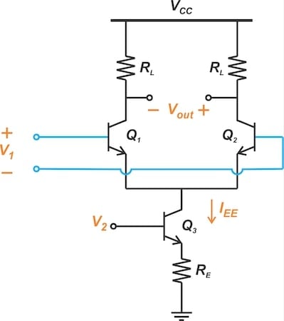

Emitter-Coupled Pair as a Simple Multiplier
Analog multiplication can be performed using a differential amplifier with a variable transconductance. The Gilbert cell is a modified version of this circuit, which is illustrated in Figure 1.
An emitter-coupled pair functions as a simple analog multiplier.
Figure 1. An emitter-coupled pair functions as a simple analog multiplier. Image used courtesy of Steve Arar
In this circuit, one input (V1) is applied to the differential pair. The other input (V2) is used to control the current through the differential pair.
A differential pair is a nonlinear circuit. However, for a small V1, the circuit behaves as a constant-gain amplifier. Under the assumption that V1 is small and the bias current (IEE) is fixed, the output voltage can be expressed as:
$$V_{out} ~\approx~ g_m R_L V_1$$
Equation 1.
where gm denotes the transconductance of each transistor in the differential pair, as given by:
$$g_m ~=~ \frac{I_c}{V_T} ~=~ \frac{I_{EE}}{2V_T}$$
Equation 2.
In the above equation, Ic denotes the collector current, and VT is the thermal voltage. The bias current of the emitter-coupled pair is given by:
$$I_{EE} ~=~ \frac{V_2 - V_{BE}}{R_E} ~\approx~ \frac{V_2}{R_E}$$
Equation 3.
where VBE is the voltage drop across the base-emitter junction. Note that the approximation in Equation 3 assumes that V2 is much greater than VBE (about 0.7 V).
Combining Equations 1 through 3, the output voltage may be expressed as:
$$V_{out} ~\approx~ \frac{R_L}{2 R_E V_T} ~\times~ V_1 V_2$$
Equation 4.
which shows that the output voltage is proportional to the product of the two input signals.
Before we move on to discussing the Gilbert multiplier, a few points are worth bringing up here. For one thing, it's important to remember that Equation 4 relies on Equations 1 through 3. It is therefore only valid if V1 is small (Equation 1) and V2 ≫ VBE (Equation 3).
Because V2 must remain positive, the multiplier function is limited to only two quadrants of the V1-V2 plane. For that reason, the basic emitter-coupled pair is often referred to as a two-quadrant multiplier. One- and two-quadrant multipliers typically have simpler circuitry compared to four-quadrant multipliers.
Finally, although it may not be immediately obvious, a fundamental characteristic that enables an emitter-coupled pair to act as a multiplier is that the transconductance of a bipolar transistor is proportional to its collector current (see Equation 2). This relationship between the collector current (Ic) and the transconductance (gm) results from the exponential transfer function of bipolar transistors.
Given that gm is proportional to Ic, we create a multiplier by making Ic proportional to the second input voltage (V2). As a result, the emitter-coupled pair requires bipolar transistors. This is also true of the original Gilbert multiplier, which is the circuit we'll examine in the rest of this article.

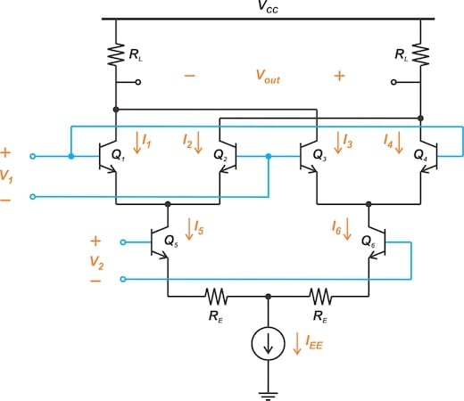

The Gilbert Multiplier: Simplified Analysis
The Gilbert multiplier is a modified emitter-coupled pair that can perform four-quadrant multiplication. Its core structure is shown in Figure 2.
The core configuration of a Gilbert multiplier.
Figure 2. The core configuration of a Gilbert multiplier. Image used courtesy of Steve Arar
To accurately analyze the above circuit, we must take into account the exponential transfer function of the bipolar transistors. However, using a linear model for the transistors still yields useful insights into the circuit's operation.
Let's take a look at the simplified analysis. With the currents shown in Figure 2, the output voltage is:
$$\begin{eqnarray} V_o &~=~& -R_L (I_2 ~+~ I_4) ~+~ R_L (I_1 ~+~ I_3) \\ &~=~& R_L \Big ( (I_1 ~-~ I_2) ~+~ (I_3 ~-~ I_4) \Big ) \end{eqnarray}$$
Equation 5.
Assuming that V1 is a small signal, we have:
$$I_1 ~-~ I_2 ~=~ g_{m1}V_1 \quad \text{and} \quad I_4 ~-~ I_3 ~=~ g_{m3}V_1$$
Equation 6.
where:
gm1 is the transconductance of the transistors Q1 and Q2
gm3 is the transconductance of the transistors Q3 and Q4.
Substituting Equation 6 into Equation 5, we obtain:
$$V_o ~=~ R_L \Big ( g_{m1}V_1 ~-~ g_{m3}V_1 \Big ) ~=~ R_L V_1 (g_{m1}~-~g_{m3})$$
Equation 7.
Assuming that the bias currents through Q1 and Q2 are I5/2 and the bias currents through Q3 and Q4 are I6/2, we may express the transconductances gm1 and gm3 as:
$$g_{m1} ~=~ \frac{I_5}{2V_T} \quad \text{and} \quad g_{m3} ~=~ \frac{I_6}{2V_T}$$
Equation 8.
Combining Equations 7 and 8 produces:
$$V_o ~=~ \frac{R_L V_1}{2V_T} (I_5 ~-~ I_6)$$
Equation 9.
Applying Kirchhoff's Voltage Law in the loop that includes V2 and the base-emitter junctions of Q5 and Q6, we have:
$$V_2 ~=~ V_{BE,5} ~+~ R_E I_5 ~-~ R_E I_6 ~-~ V_{BE,6} ~\approx~ R_E (I_5 ~-~ I_6)$$
Equation 10.
Combining the last two equations, we have:
$$V_o ~=~ \frac{R_L}{2R_E V_T} ~\times~ V_1 V_2$$
Equation 11.
which indicates that the circuit operates as a multiplier.

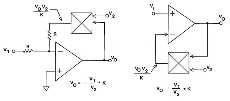

Implementing Arithmetic Functions With Op Amps and Multipliers
Multipliers, including the Gilbert multiplier, can be utilized within the feedback loop of an op amp to develop a range of useful functions. The fundamental concept is that by applying the output of an op amp to a specific function, F(x), and feeding the result back to the inverting input of the op amp, the amplifier's output will yield the inverse function F⁻¹(x). For instance, by placing a Gilbert cell in the feedback path, we can implement an analog divider. This is illustrated in Figure 4.
Implementing analog dividers by utilizing Gilbert cells in the feedback path of op amps.
Figure 4. Implementing analog dividers by utilizing Gilbert cells in the feedback path of op amps. Image used courtesy of Analog Devices
Note that the configuration on the left produces an inverting divider, whereas the configuration on the right is a non-inverting divider.
