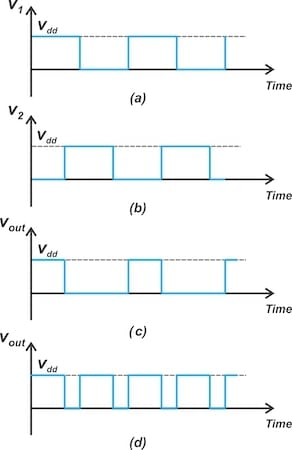

When the S input transitions from 0 to 1, the flip-flop sets the output (Q = 1), whereas a rising edge on the R input resets the output (Q = 0). By monitoring the rising edges of the inputs, the RS flip-flop can detect the phase difference between them. We can see this by examining the input and output waveforms in Figure 3. For comparison purposes, the output waveform of an XOR gate phase detector has been included as Figure 3(d).
From top to bottom: Waveforms of input v1, inputv2, the output of the RS flip-flop phase detector, and the output of the XOR phase detector.
Figure 3. From top to bottom: Waveforms of input v1, input v2, the output of the RS flip-flop phase detector, and the output of the XOR phase detector.

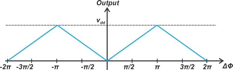

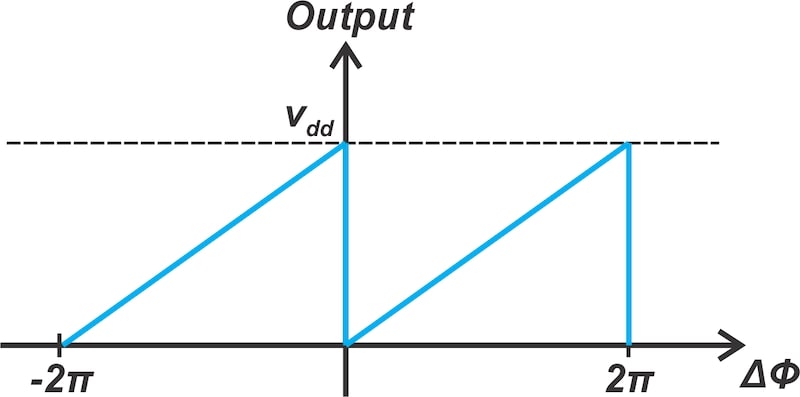

The duty cycle of the output varies from zero to one based on the phase difference between the inputs. Therefore, much like the XOR phase detector, the average value of the output waveform represents the phase difference between the inputs. Figure 4 shows the average of the RS flip-flop phase detector's output versus the input phase difference.
The RS flip-flop phase detector's input-output characteristic.
Figure 4. The RS flip-flop phase detector's input-output characteristic.
Note that the output reaches its maximum when the phase error is 2π radians. This shows that the RS flip-flop phase detector has an input phase error range twice that of the XOR phase detector.
Inspection of Figure 4 shows that the gain of this phase detector is:
$$k_d ~=~ \frac{V_{dd}}{2 \pi}$$
Equation 1.
We also see in Figure 4 that the gain at the metastable point is extremely high (ideally infinite). This means the chance of the loop staying in that state is much lower than it is for the XOR detector.

One drawback of this phase detector is that it requires more filtering than the XOR detector. This is because, as illustrated in Figure 3(d), the XOR phase detector produces output signals at twice the input frequency. By contrast, the RS detector's output frequency is the same as the input frequency. The lowpass filter requirements are therefore less stringent when using an XOR detector.

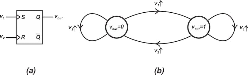

The RS detector is a two-state device. This is illustrated by the state diagram in Figure 5.
The RS flip-flop phase detector and its equivalent-state machine.
Figure 5. The RS flip-flop phase detector (a) and its equivalent-state machine (b).
In the above diagram, the upward-pointing arrow denotes a rising transition on the corresponding input. When a positive transition occurs on the set input, the system enters the vout = 1 state and remains there if further positive transitions happen on this input. However, a positive transition on the reset input takes the system from the vout = 1 state to the vout = 0 state. The system remains in the vout = 0 state if additional positive transitions occur on the reset input.
Sequential phase detectors focus solely on the transitions of the signals. Unlike the XOR detector, the duty cycle of the input signals is irrelevant when using the RS flip-flop phase detector. This means that missing or poorly defined signal transitions can lead to incorrect behavior.
Compared to either an XOR or multiplier-type phase detector, the RS detector is more vulnerable to noise. Sequential phase detectors preserve noise errors through their memory effect. This renders these circuits suitable exclusively for high signal-to-noise ratio (SNR) applications.

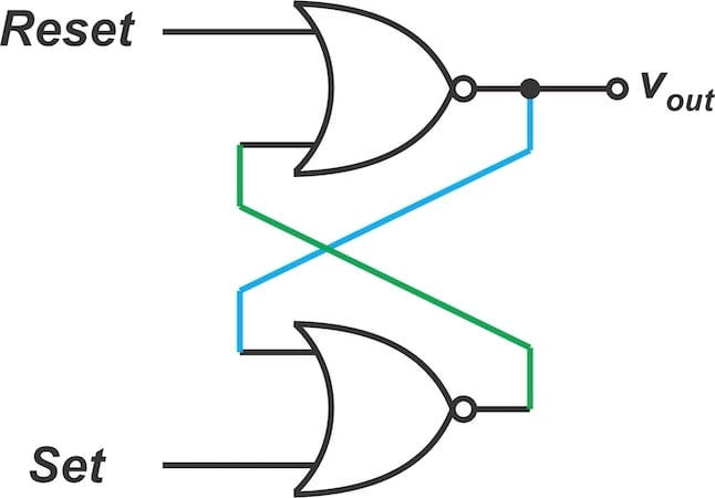

When utilizing an RS flip-flop as a phase detector, it's vital for the flip-flop to carry out set and reset operations with equal speed. If this condition is not met, the input-output characteristic will differ from the ideal one illustrated in Figure 4, indicating a static phase error. For example, the RS flip-flop using cross-coupled NOR gates presented in Figure 6 resets faster than it sets. As a result, it may not be ideal for phase detection applications.
RS flip-flop that executes the reset operation faster than the set operation.
Figure 6. This RS flip-flop executes the reset operation more quickly than the set operation.

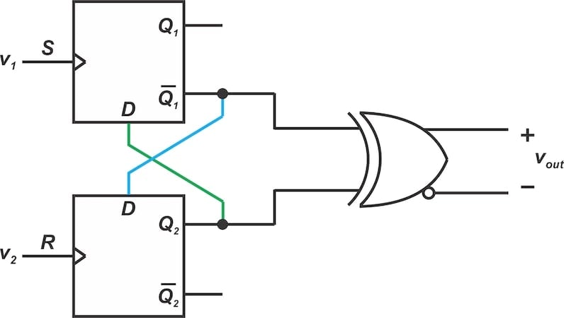

Figure 7 shows a more suitable implementation of the RS flip-flop phase detector. This configuration is capable of performing set and reset functions at equal speeds.
Circuit implementation of the RS flip-flop phase detector.
Figure 7. Circuit implementation of the RS flip-flop phase detector.
A rising edge on v1 results in Q1 being equal to Q2. Since Q2 and the inverted value of Q1 are fed into the XOR gate, the output goes HIGH, indicating the set state. Conversely, when a rising edge appears on v2, Q2 takes on the inverted value of Q1. This results in a logic-low at the XOR output, signifying the reset state.

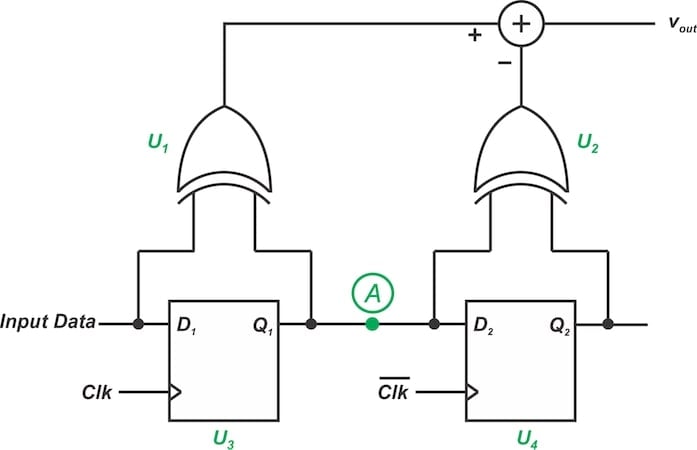

A variety of inventive designs have been created to tackle the problem of sensitivity to missing edges in sequential phase detectors. Figure 8 shows one of these circuits, known as Hogge's phase detector. It operates by determining the transitions in the input data, making it less sensitive to missing edges.
Figure 8. Hogge's phase detector.
The circuit determines the phase difference between Input Data and the clock signal denoted by Clk. To avoid sensitivity to missing edges of the input data, the circuit does nothing when input pulses are missing.
The D flip-flop U3, in conjunction with the XOR gate U1, detects transitions in the input data, generating a positive pulse at the output of U1 for each data transition. The width of these pulses depends on the phase error between the input data and the clock.
The D flip-flop U4, along with the XOR gate U2, also detects the transitions in the input data, producing a positive pulse at the output of U2 for each data transition. However, the width of these pulses is fixed and equal to half the clock period. The phase error can be determined by comparing the widths of the pulses produced by U1 and U2.
