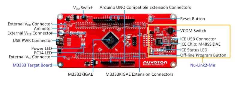

NuMaker-M3333KI evaluation board
Development support includes the NuMaker-M3333KI (see above) and NuMaker-M3334KI evaluation boards, with software compatibility across FreeRTOS, Zephyr, RT-Thread, emWin, and LVGL.
