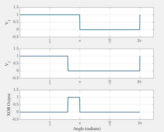

To understand this response, let's evaluate the input and output waveforms at specific phase differences. We'll begin with Figure 6, where the phase difference is zero.
Input and output waveforms when one input has a 40% duty cycle and there is 0 input phase difference.
Figure 6. The waveforms of the inputs V1 (top) and V2 (middle), and the resulting output waveform (bottom). V2 features a 40% duty cycle, and there is zero phase difference between the inputs.
Notice that the difference in duty cycles produces a non-zero average output. You can easily see that the 0.1 V average value will remain unchanged if we introduce a phase difference of less than 0.2π ≈ 0.62 radians. To illustrate this point, Figure 7 shows the waveforms when the phase difference is 0.2π radians.

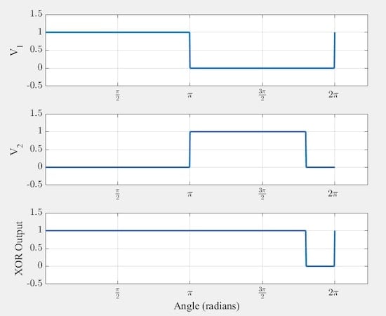

As Δϕ surpasses 0.2π radians, the overlap between the two input waveforms diminishes, resulting in a higher average output value. This pattern persists until Δϕ = π radians (Figure 8).
The input and output waveforms when the phase difference is π radians.
Figure 8. The input and output waveforms when the phase difference is π radians.
In this case, the average output value can be easily calculated as 0.9 V, which aligns with the characteristic shown in Figure 5.

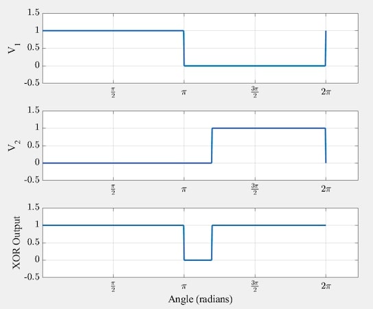

For π < Δϕ < 1.2π, the average output remains constant. To help us visualize this, Figure 9 shows the waveforms for Δϕ = 1.2π radians.
The waveforms of the input and output when the phase difference is 1.2π radians.
Figure 9. The input and output waveforms when the phase difference is 1.2π radians.

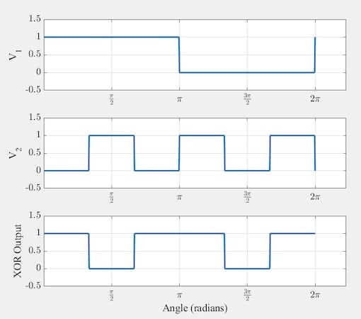

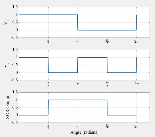

We'll now examine the odd harmonics. Figure 12 shows example waveforms where the input V2 corresponds to the third harmonic of V1.
The waveforms of the inputs and output when one input is at the third harmonic frequency of the other.
Figure 12. The input and output waveforms when V2 is at the third harmonic frequency of V1.
As with the second-harmonic case, the output waveform is formed by alternating between portions of V2 and its inverted versions. However, the portion of V2 contained in one half cycle of V1 is not a whole multiple of the period of V2. This makes the average output dependent on the phase difference between the input signals.
For example, with the waveforms shown in Figure 12, the average output is Vdd/3. However, with the waveforms shown in Figure 13, the average output is 2Vdd/3. This shows that the average output depends on the phase difference between the inputs.
A second set of waveforms illustrating the XOR phase detector operation when one input is the third harmonic of the other.
Figure 13. A second set of waveforms illustrating the XOR phase detector's operation when one input is the third harmonic of the other.
The waveforms in Figures 12 and 13 illustrate the scenarios that produce the minimum and maximum outputs for a third-harmonic input. The average output varies between Vdd/3 and 2Vdd/3, depending on the phase difference between the inputs. This results in a total output variation of Vdd/3, which is one-third of the output variation achieved when both inputs are at the same frequency (see Figure 4).
