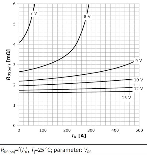

The typical drain‑source on-resistance of the OptiMOS Linear FET 2 MOSFET
The typical drain‑source on-resistance of the OptiMOS Linear FET 2 MOSFET. Image used courtesy of Infineon
The new MOSFET operates at up to 100 V and 243 A and as low as 2.3 mΩ RDS(on). Compared to a standard OptiMOS 5 with a similar RDS(on), this gives the new MOSFET a 12 times higher SOA (54 V at 10 ms) and 3.5 times higher SOA at 100 µs.

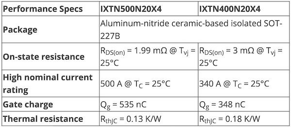

Littelfuse has announced a pair of high-performance Ultra Junction X4-Class 200-V power MOSFETs. Littelfuse claims the IXTN400N20X4 and IXTN500N20X4 have industry-leading on-state resistance targeted at battery and power supply applications.
The new parts add to the company's existing 200-V Ultra Junction X4-class MOSFET product line. The two MOSFETs have RDS(on) values of 1.99 mΩ for the IXTN400N20X4 and 3 mΩ for the IXTN500N20X4. Compared to the existing X4-Class MOSFET solutions, the new parts offer up to double the current ratings and up to ~63% lower RDS(on) values.
Key specifications for Littelfuse's IXTN400N20X4 and IXTN500N20X4 MOSFETs
Key specifications for Littelfuse's IXTN400N20X4 and IXTN500N20X4 MOSFETs. Table used courtesy of Littelfuse
The current capability of these two parts comes in both the silicon and the packaging. The screw-mount terminal SOT-227B package has superior thermal properties. The high current capacity and low resistance allow single parts to replace multiple lower-current parallel MOSFETs in a power circuit design. Putting multiple parts into one reduces cost and design time and can lead to a more robust product. Littelfuse expects the MOSFETs to go into battery products such as storage, chargers, load switches, and power supplies.
