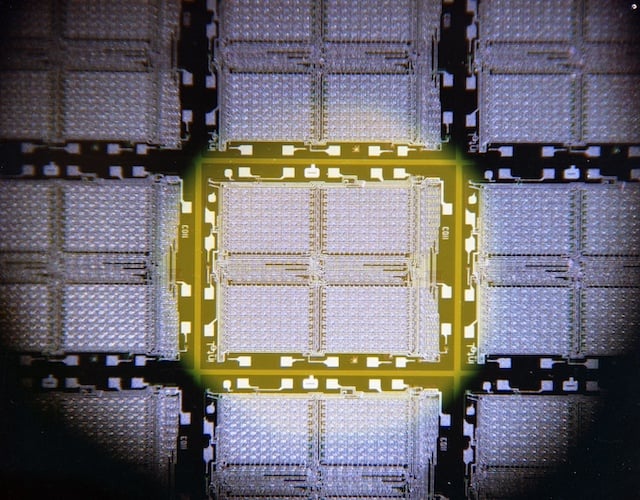

1103
Intel calls the 1103 the “death knell for magnetic core memory's dominance.” Image used courtesy of Intel
The 1103A became a drop-in replacement, dramatically simplifying memory controller design and improving adoption rates. With the bugs ironed out, system vendors flocked to it. Systems like HP’s 9800 series, DEC’s PDP-11, and various Honeywell minis adopted the 1103/1103A for main memory. Intel quickly spun out a family of support ICs to reduce integration effort further.
