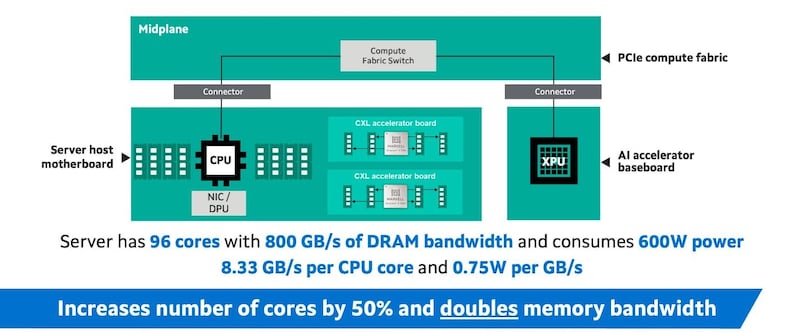

Structera server accelerator architecture
Structera server accelerator architecture. Image used courtesy of Marvell

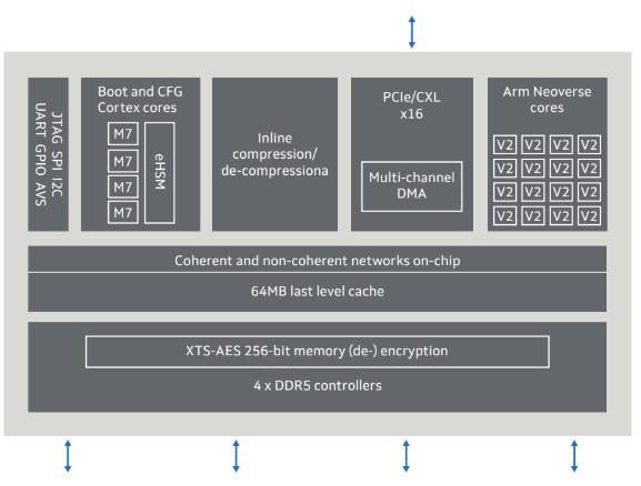

The Structera A near-memory accelerators feature server-class Arm Neoverse V2 cores, DDR5 support, and up to 1.6 Tbps of memory bandwidth. Marvell optimized the devices particularly for high-bandwidth workloads such as deep learning recommendation models (DLRM). Structera A can also offload memory-intensive processes such as AI, ML, or in-memory databases to its server-class Arm cores.
Block diagram of the Structera A 2504 CXL controller
Block diagram of the Structera A 2504 CXL controller. Image used courtesy of Marvell

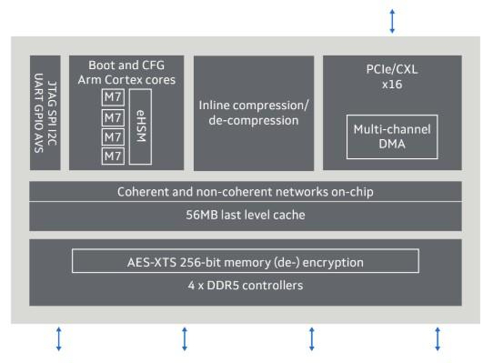

The Structera X memory expansion controllers support DDR4 and DDR5 DIMMs, enabling the deployment of terabytes of memory capacity while optimizing both cost efficiency and power consumption.
Structera X block diagram
Structera X block diagram. Image used courtesy of Marvell
