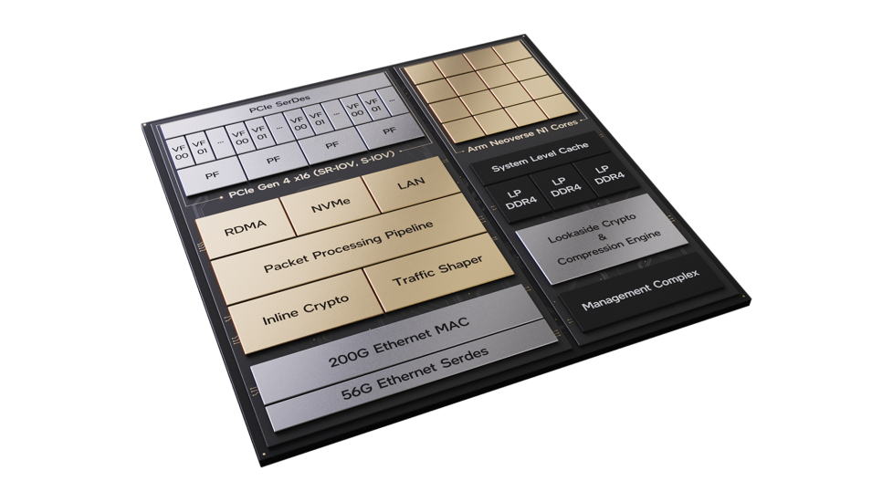

At the heart of Google’s new C3 machine series is Intel’s IPU E2000, a custom infrastructure computing ASIC that Google and Intel developed together.
One of the key requirements for the IPU was programmability; the chip needed to be flexible enough to be optimized for any given computing requirement. To achieve this high level of programmability, Intel drew inspiration for E2000’s architecture from the design philosophies and successes of its FPGA SmartNICs. The result is a highly programmable packet processing engine that will be used to offload packet processing tasks from the C3’s CPU at line rates up to 200 Gb/s.
Intel’s IPU E2000
Intel’s IPU E2000. Image used courtesy of Intel
Beyond programmability, Intel highlighted other key features of the E2000, including an NVM Express storage interface, an advanced crypto engine, and compression acceleration blocks. Other hardware features include up to 2 x 100 GbE connectivity, 16 Arm Neoverse N1 cores, and 48 GB of onboard DRAM.
